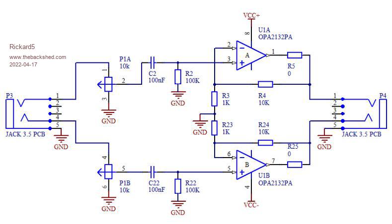

Since I Built my PM VGA I've been thinking of building another CMOY headphone amp to use as a Preamp for a set of Cheep 8ohm powered Dell speaker bar Total BOM Cost like $4

Thats an 8MHz amp, don't it need some 20KHz lowpass?

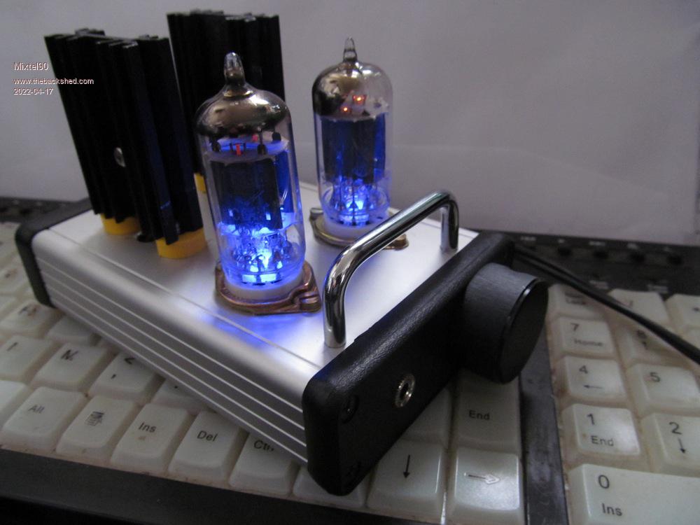

*This* is a headphone amp. :)
Paralleled ECC82/12AU7 direct coupled to a MOSFET source follower to drive headphones. The valve heaters are the MOSFET source resistor. It sounds beautiful - but isn't as portable as the Cmoy - especially with the SMPS that powers it. lol It's the "Starving Student" circuit, slightly modified to use a valve that's are actually available. The two shown in the photo are probably not far off my age. My late dad and myself took a lot of old valve TVs to pieces between us when I was a youngster (to re-use the components) and I kept a lot of the valves.
I'm intending to try Volhout's emitter follower and a couple of variations today. I could do with a different arrangement for the next revision of PicoGAME really. I suspect it would be used with headphones more than with speakers.
I'm beginning to suspect that it won't be possible to run the PicoMite SMPS and that a linear regulator will be necessary. That's purely because of noise levels. It doesn't really matter - the regulator is cheap and quite easy to get and there is no big current demand as there is no external I/O to worry about.
To get a decent output volume to headphones I need a big output from the PicoMite as an emitter follower reduces the impedance (increases the drive current) but has no voltage gain. Consequently any noise from the PicoMite (or on the 5V supply) is going to go to the headphones. At the moment I'm thinking of filtering the 5V a bit to help with that.
