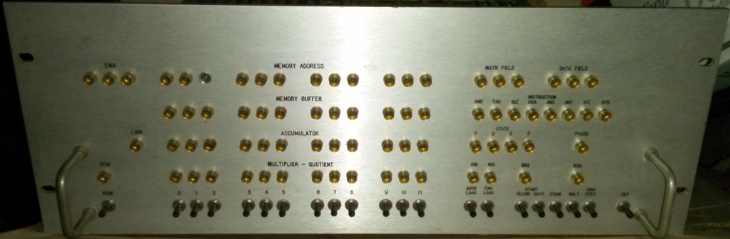

Posted: 07:35am 19 Apr 2022
Raise you my father's 1973 PDP8E (20MHz nothing but instruction set copied from DEC)
Missing the memory core and none of DEC's schematics match.
All documentation was shredded by his 2nd wife.
Edited 2022-04-19 17:47 by KD5ZXG
Posts: 9265
Posted: 07:52am 19 Apr 2022
Shame about that. It's very pretty though. He did a lovely job of that front panel. :)

Posted: 07:02pm 19 Apr 2022
Psycho erasing all evidence her victim ever lived. First thing to do after a successful murder. Fortunately I was watching the curb for trash and salvaged his front panel. At least three of this cursed design were built, and all ended horribly via wives. Jim Ferguson of Xerox 820 and Big Board fame. I don't remember the other. Trying to make it work again probably not a good idea.
Front panel was made with assistance from Bill Romans who still lives last I spoke with him a decade ago. He never built a whole machine and has no documentation. So owning the inactive panel alone appears safe.
