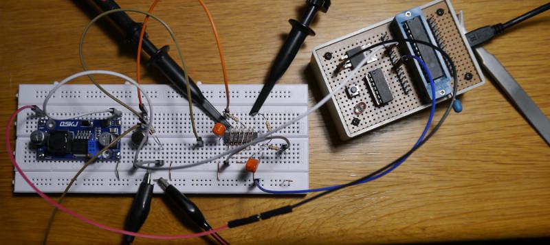

this is all built up on a solderless breadboard, with absolutely atrocious noise everywhere
next step is building a thermal chamber, and characterizing the drift of the LT1021-5 reference (untrimmed) over the range 5 degrees C to 40 degrees C.

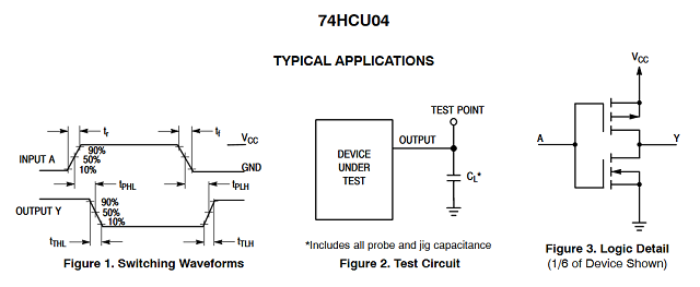

(retrieved from: http://pdf-html.ic37.com/pdf_file_A/20200531/pdf_pdf/pdf4/ONSEMI/74HCU04_datasheet_830450/135209/74HCU04_datasheet.pdf)
you are 100% right, i need the full 5 volt drive on the PWM signal going into the 74HCU04. this explains a 0.15v low level output i was seeing when the PWM signal was driven high. will try convering the PWM to 5v levels this evening and see how it looks.

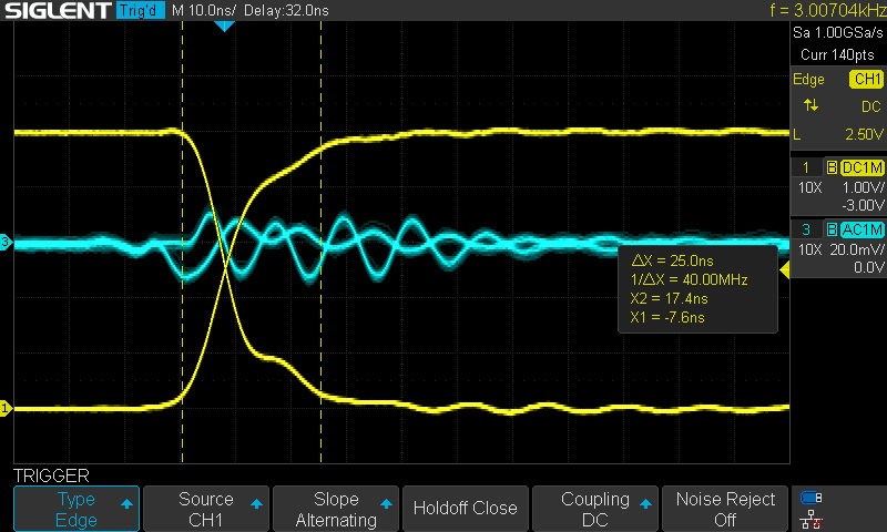

good point, i had been hoping that the BC547 + 4k7 would be 'just good enough' for the job     this evening i tested a slightly simpler approach, reconfiguring the 74HCU04 as a single gate at the input end, that then driving into the remaining five. the BC547 et al are now eliminated, and the output at the 5x paralleled outputs looks like this:
the cursors (dotted vertical lines) are set 25ns apart, or the equivalent of one 40MHz CPU clock cycle of the micromite. as can be seen (yellow trace), both the high-low and low-high transitions now complete within this time interval, and are fairly closely matched in slope. the result is better than i expected!
the blue trace (AC coupled) shows ripple of 30mv or so on the reference output at each transition. note that both scope channels are set to 20MHz bandwidth limiting. my shoddy solderless breadboard assembly with long jumper wires is an RF nightmare.
