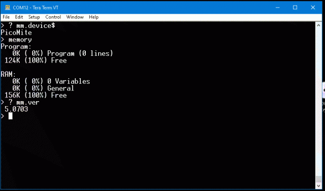

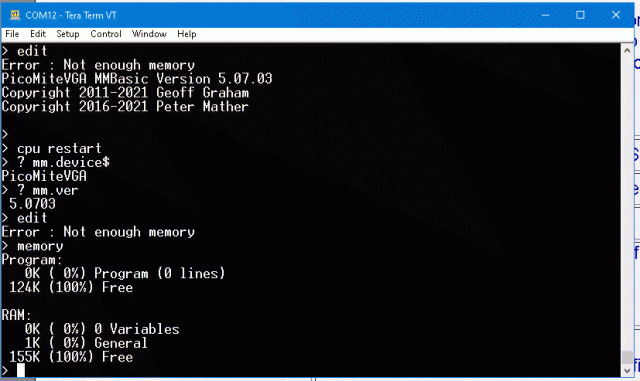

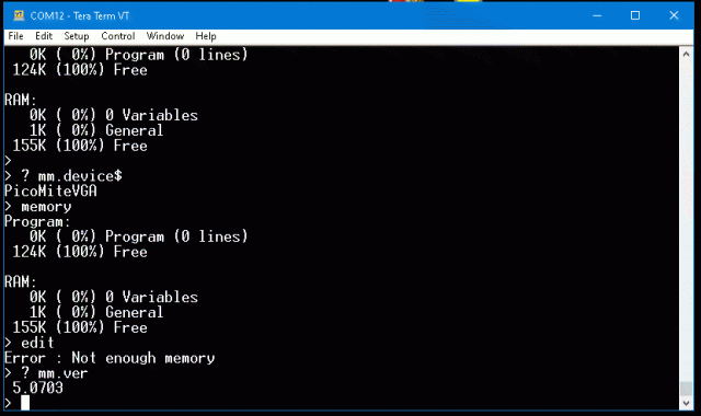

Cannot enter the editor - says there is not enough memory, when there appears to be plenty:
Peter?
EDIT: Anyone else seeing this on the latest VGA firmware?
I can roll-back the VGA firmware to 5.0301b2(clear_flash.uf2 first), and the editor works in that one - I can call it up fine and it works, but not in either 5.0703 RC1 or 5.0703 Final 1.
I also tried running clear_flash.uf2 on the final just to be sure, but I am pretty sure that RC1 and F1 both automatically clear the flash as part of the firmware.
I will now try loading the NON VGA F1 firmware and see if I can get into the editor in that one.
EDIT: Latest final version of the NON-VGA firmware, the editor works fine.
EDIT: I just reflashed the F1 VGA version, just in case something odd happened during the first flashing, but the error remains, so I think there is a bug in the VGA version with respect to entering the editor?

  Quote  Cannot enter the editor - says there is not enough memory, when there appears to be plenty:
The issue is that you swapped firmware from PicoMite to PicoMiteVGA. If you do this you MUST use OPTION RESET to reset the RAM amount.
Note in your screenshot it says 124KB program space i.e. PicoMite but the banner says PicoMiteVGA
I'll make the firmware force this in the next beta
