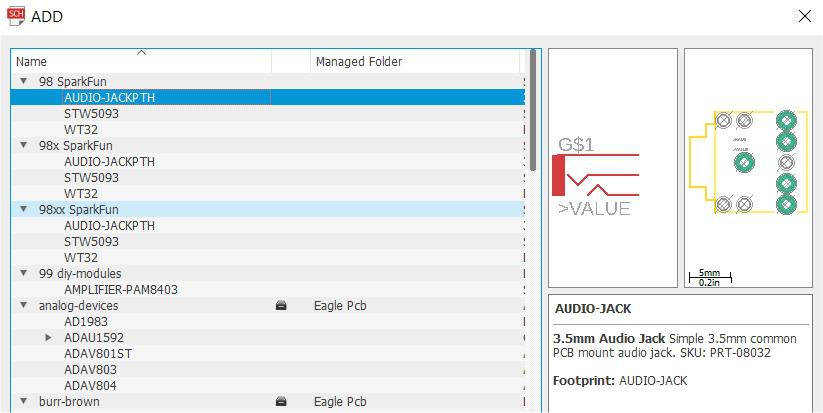

I'm designing a Picomite PCB and want to add a standard 3.5mm audio jack (Tip, Ring, Sleeve) to allow plugging in "standard" amplified speakers (like those used for PCs).
There are various types of 3.5mm audio connectors for PCBs and I'm trying to figure out which one to use.
Since this is for audio output only, I don't need the kind of jack that senses when something has been plugged in. Just GND, Left and Right audio out is fine.
I need something commonly available and cheap, preferable with a datasheet.
What do you recommend? (Ideal if there is an Eagle library so I don't have to create the part!)
Edited 2022-01-23 03:53 by flasherror
Posted: 06:26pm 22 Jan 2022
Sparkfun has this Eaglecad part for a largish 3.5mm audio socket:
I have used a footprint with 5 or 6 pins organized as dual-in-line, but I can't find it now.

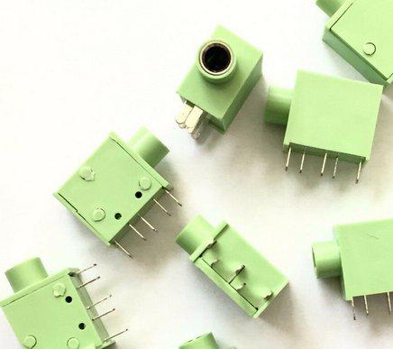

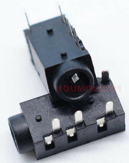

I see looking online there are also other types:
3.5mm 4-pin:
3.5mm 5-pin:
