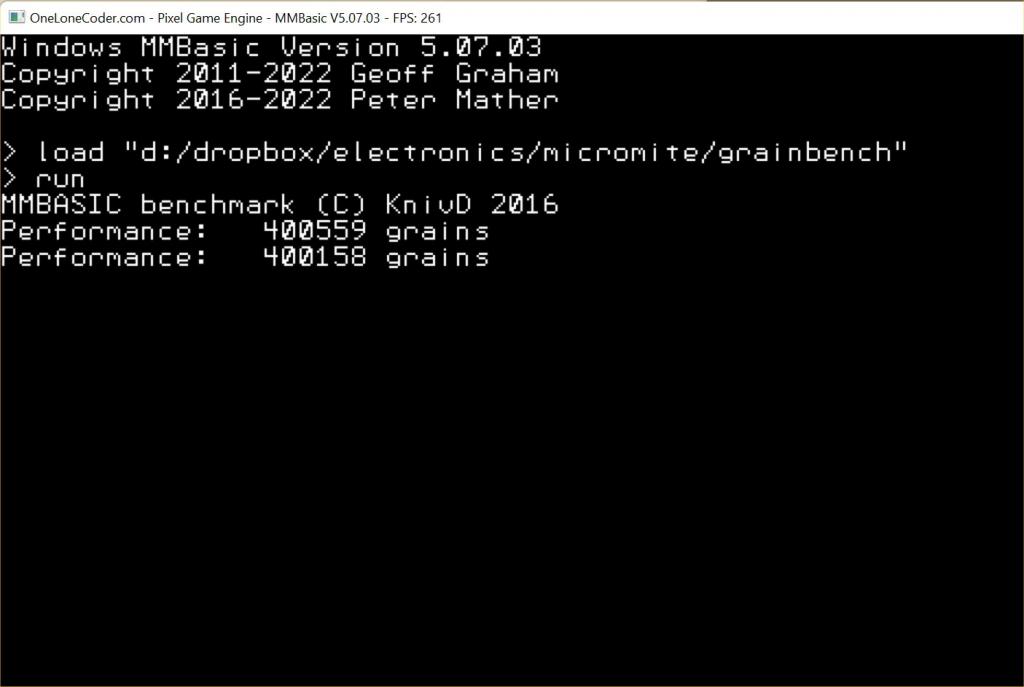

Posted: 10:56pm 23 Jan 2022
More progress

  matherp said  More progress
What did you do ?
The current 5.05.01 DOS version runs 123570 grains on a i9 (absolutely not the slowest machine). 3x more performance. WAUW...
Posted: 10:04am 24 Jan 2022
  Quote  What did you do ?
As they say in the song "It's a kind of magic"
