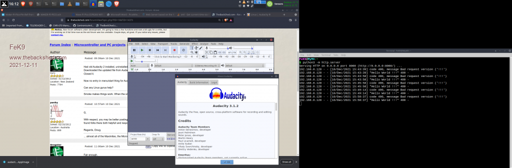

Audacity did release a linux version in AppImage format, it's a little like
VMware VMBox Docker Wine etc...
My Mint duel boot Mini-Pc is at the office, here at home I use ageing
1st gen i3 laptop from 2011, with a lighter version Debian called MXlinux
similar to Linux Mint.  My MXlinux audio interface gives me a little grief
some times, can not test Audacity properly... :(

I found that I can make version 3.1 run, if I REINSTALL the older 2.4 via the Software Manager, and then copy the Audacity Appimage to the desktop and run that.
Perhaps not ideal, but it works.  I would love to know how to change the ICON from the cog to(ideally) the Audacity one.  I know you can use emblems, but they are not icons, so a change icon method would be handy to know at this point.
EDIT: Oh, BTW, this is Audacity in Mint, not in the VM.
