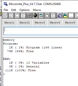

Posted: 02:12pm 04 Nov 2021
This works perfectly
Edited 2021-11-05 00:14 by Tinine
Posted: 02:28pm 04 Nov 2021
  Tinine said  This works perfectly
What are we looking at here?
Only when I noted what the image file is named do I have much of a clue: PGA2040 Running MMBasic.PNG (aside from the raspberry pi logo on the chip).

Posted: 02:30pm 04 Nov 2021
This one from Pimoroni

Posted: 05:02pm 04 Nov 2021
OK, looks like I bricked it.
Attempted to go above 250MHz and MMBasic complained. Selected 245MHz and, as expected, lost the connection. Would not reconnect, port no-longer shows-up in device manager and of course, can't re-flash.
Posts: 9271
Posted: 05:11pm 04 Nov 2021
Aawwww....  Poor little thing...  :(
Tinine
Joined: 30/03/2016
Posts: 1646
Posted: 05:15pm 04 Nov 2021
  Mixtel90 said  Aawwww....  Poor little thing...  :(
Nope...it's back again
No amount of unplugging the USB made a difference but apparently it was Windoze that got its knickers in a twist.
Power-cycled the PC and all was good. Nuked the flash and re-flashed with MMBasic...all good
Edited 2021-11-05 03:16 by Tinine

Posts: 12084
Posted: 07:22pm 04 Nov 2021
  Quote  Selected 245MHz and, as expected, lost the connection
The speed has to be such that the PLL can generate the 48MHz clock for USB. I haven't tried to check the validity of speeds as nothing I tried has given a problem thus far. Would certainly suggest you stick to multiples of 8 though. Did you try 250MHz which is known good (as is 200)
Edited 2021-11-05 05:23 by matherp
Tinine
Joined: 30/03/2016
Posts: 1646
Posted: 07:36pm 04 Nov 2021
Yeah, 250MHz seems rock solid. I only tried 245MHz to see if it would take weird values.

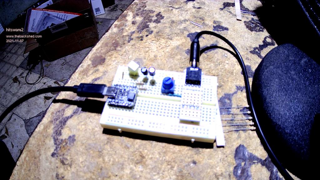

Posted: 09:41pm 06 Nov 2021
Happy to say !
This One
Working fine ( V5.07.01b5.uf2 )
Evedently I got my wires crossed with the first one
my site
Posts: 9271
Posted: 10:26pm 06 Nov 2021
Nice little board. :)
