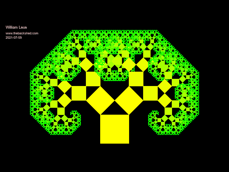

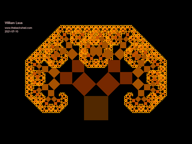

I couldn't resist updating this program to add seasonal colors to the 'tree' for fall and winter as well as the original summer colors.
-Bill

Posted: 04:15pm 09 Jul 2021
Beautiful. Thanks. Such a small program for such a rich image.
