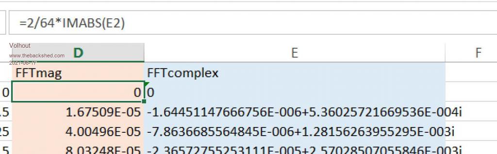

Please find attached excel file. The data in the yellow column is data from the picomite using a hann window over a 10 cycle sine wave.
fft_in_excel.zip
The blue column is the complex FFT that excel calculates from this data.
The red column is the magnitude calculated from the complex FFT data.
I did not invent this myself, this was from a web tutorial. You have to install the excel data analysis package to re-run the excel FFT.
I hope this helps.

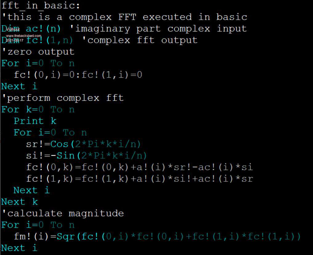

Some additional information:
I have written the complex FFT in basic on the pi-pico, and when I run that code on the hann windowed 10 sine wave input signal, I get the same response at EXCEL.
This means that the problem is not in the input data.
The fft basic code:
Array a!() contains the real input values.

  Quote  The red column is the magnitude calculated from the complex FFT data.
The magnitude in the spreadsheet doesn't make sense unless I'm missing something as usual. Look at line 12 of the spreadsheet. Shouldn't the magnitude be something bigger than 255? sqrt(255.6^2 + 7.8^2)
Posts: 6209
Posted: 12:57pm 17 Jun 2021
Hi Peter,
You are right. That is what happens when you simply copy what is on the internet, and don't check every step.
There is a multiplication with 2/64 (divide by 32). No idea why. Maybe to tune the values into a certain range (0..8) ....
Sorry for the confusion ...

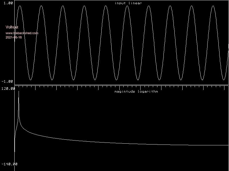

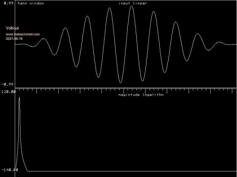

YEESSSSSS, that is it. An immediately the immense resolution of the 64bit variables shows. As a technician I am truely impressed. May I ask what caused it ?
Here some proof (an showing the effect of windowing the input data).
Raw data (as if from an ADC)
The FFT window shows data on logaritmic scale, so be impressed, even with the raw data. In linear mode it only shows a peak and then a flat line at 0.
Data with Hann window. The peak is the sine frequency, you can see that the spurious are far below -140dB (if you check the data there is even -680dB, that is beyond the measurement range of anything I know. Not even the super cooled Hubbel telescope get's even near. Anyway, this is definitely compatible with 24bit ADC's, and won't degrade the performance in any way.
Thank you for fixing this.
