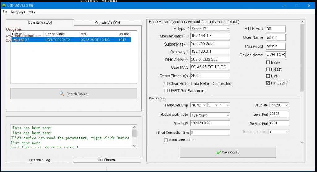

One of these arrived today, so I thought I would have a play around, but I cannot talk to the thing at all.  I think it is cos it is in another network from my LAN...
According to the manual, its default IP address is 192.168.0.7
ALL my PC's on my LAN are in the 192.168.1.x range, with subnet mask of 255.255.255.0, so I think that is where the issue is.
QUESTION: If my machines are in 192.168.1.X, should I still be able to see and talk to other machines in the 192.168.0.X range, or are they essentially blocked?
Advanced IP Scanner cannot see the module at all, PING at command-prompt can't see it either.
EDIT: It's definitely alive and detectable:
...but I can't PING it, and I can't talk to it via a browser.  The module has a built-in web-server for configuration which is what I am trying to use, but I could just use this for configuration I guess....
I will probably want it in the same LAN anyway, so I might change its IP address now to 192.168.1.X, and then see if I can PING it and/or load up the web-interface.

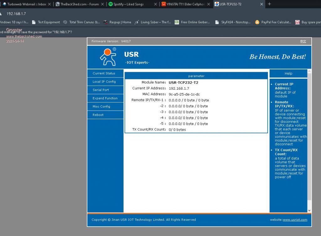

Yep, all up and running now that I put it in the same LAN:
Set the module to 192.168.1.7, and then I can PING it, AND talk to it via the web-interface.

The next step will be to configure for 38k4, and connect it to a spare MM2 chip and play with accessing the MM console via the LAN for a start, then I might run another of those tests where I setup port-forwarding on my router and see if other members can talk to it from the WAN.
The 192.168.0.x range that it is in by default, is a bit of a gotcha, as 99% of the world that uses the private non-routable range starting with 192.168, tends to be 192.168.1.x, and that most certainly stopped me from doing a PING test or being able to talk to its web-configuration.
Sure, 192.168.0.x is a range I have come across on people's LAN too, but 192.168.1.x is far more popular and common.  No matter.  It was easy to change.
