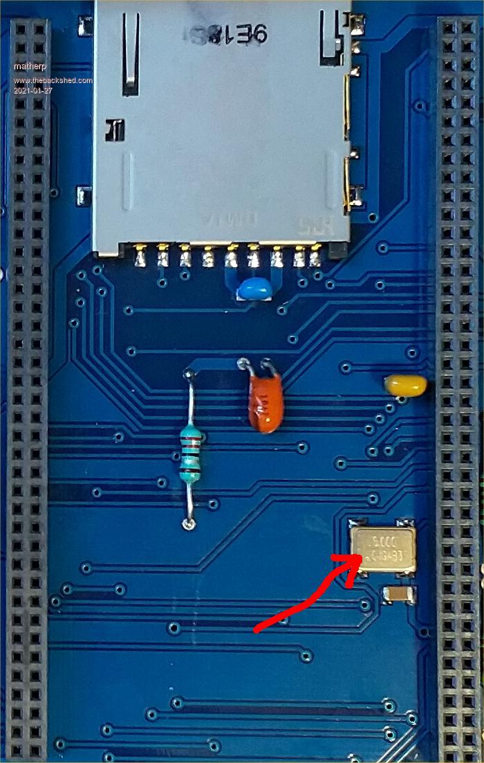

Can someone point me to a photo of what the external oscillator mod looks like ? I suspect @WhiteWizzard did mine:

Do you have a Waveshare version or the single board? If the latter then it isn't a mod it is standard. If the Waveshare then there should be a rectangular silver device on the motherboard located under the Waveshare PCB

  matherp said  Do you have a Waveshare version or the single board? If the latter then it isn't a mod it is standard. If the Waveshare then there should be a rectangular silver device on the motherboard located under the Waveshare PCB
Waveshare with resistor packs - I know the mod isn't standard, but the quote from @WhiteWizzard suggests to me he probably did it before shipping. I will take a look later, now I know what I am looking for.

Thanks for the photo. The oscillator is indeed installed and I've tested over-clocking without any smoke being generated ;-) - just need to add a toggle to my expansion board.

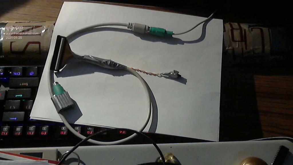

Look my Mouse adapter has grown a turbo pigtail.
This works very well and It is nice that you can switch speeds on the fly with "CPU RESTART".  I used PIN 34 for my ground because I did not want to undo the heat-shrink on the cable to get to PIN 39. I am running 40 degrees on idol at 480 with "? PIN("TEMP")" and I have a rather hefty aluminum heatsink on it and the case is closed. Is that reasonable or is something wrong? Is it a good idea to maybe put some vent holes above the CPU? Thank you for any input.
Posted: 09:14pm 27 Jan 2021
  mclout999 said  I am running 40 degrees on idol at 480 with "? PIN("TEMP")" and I have a rather hefty aluminum heatsink on it and the case is closed. Is that reasonable or is something wrong? Is it a good idea to maybe put some vent holes above the CPU? Thank you for any input.
That is on the cold side. My systems run around 50 degrees in normal room temperature.
You have nothing to worry about.
