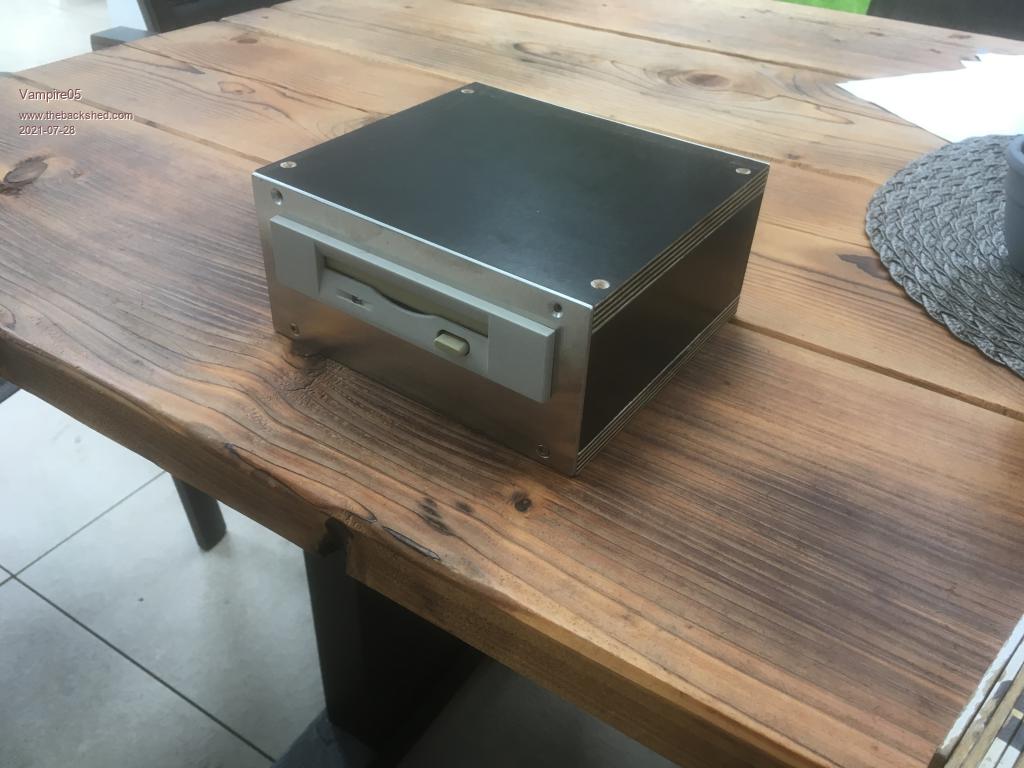

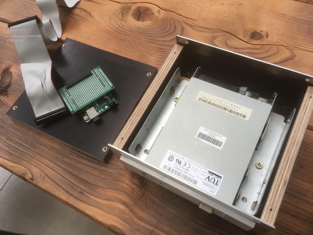

Today i finished the case for my external CMM2 Floppy Drive: Here some Pics:
The next Step is to mount an IDE (40 Pin) Connector on the backside for the CMM2 Connection.

Kingeorg
Joined: 28/12/2020
Posts: 11
Posted: 05:13pm 27 Jul 2021
Wow. That looks ROBUST!
Vampire05
Joined: 06/12/2020
Posts: 88
Posted: 05:18pm 27 Jul 2021
these wooden panels and aluminuim sheets are the only material i have lying around here.
Posts: 9273
Posted: 06:23pm 27 Jul 2021
It won't blow off the table anyway. :)
Actually, I think it looks really neat. Your cutting and assembly look very precise.
