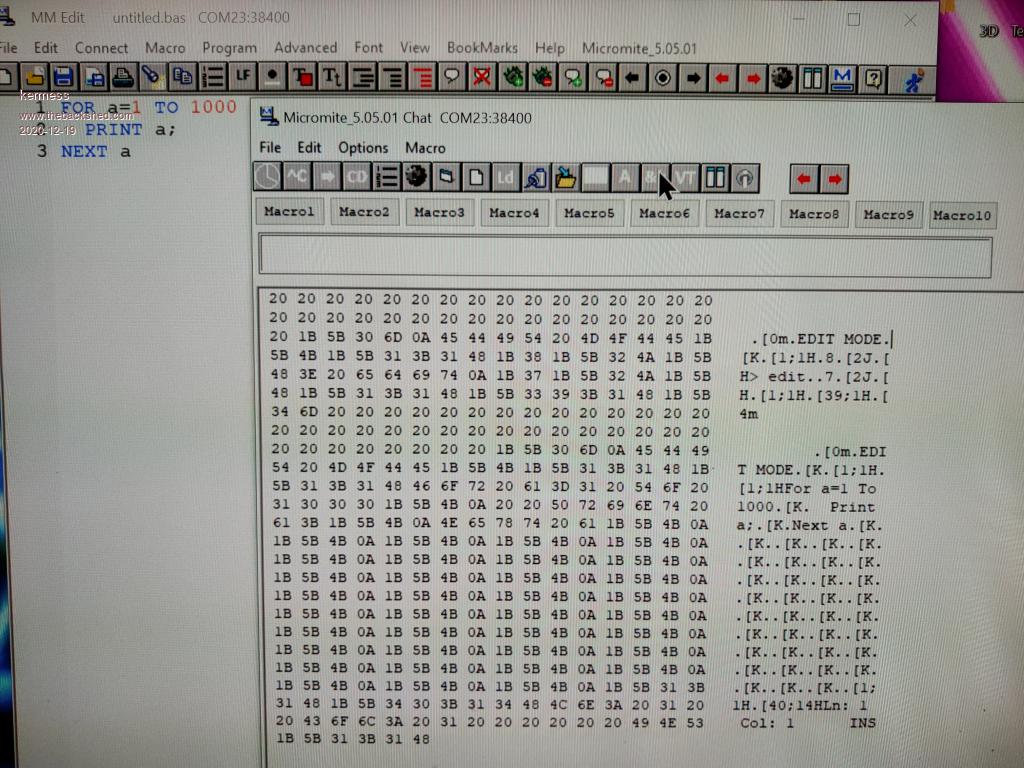

Reply message to TassyJim.
In this picture you can see a minimum of "Program" and the result in HEX.
Process.
> edit "Enter"
In Edition the three lines appear and in a second they move upwards and disappear in this minimum program it remains on the screen
  Next a
Below, the EDIT MODE line comes out but broken and part of the line is seen.
.................. n: 3 Col: 1 INS
And this is the result in HEX.
Muchas gracias.
David
Posted: 08:19pm 18 Dec 2020
I don't understand where "EDIT MODE" is coming from.
What do you have set for "OPTION DISPLAY lines [,chars]" ?
Try setting it to OPTION DISPLAY 24,80
You can also try using the test server which is running MMBasic V5.05.03
Menu Connect/Test server.

Posted: 10:37pm 18 Dec 2020
Hi Jim.
Thank you. 1000 thanks.
I've done it a thousand times but when the cables cross you don't get off the donkey.
This is what I did ..... OPTION DISPLAY 80,38 and there is the problem.
I just had to get it right.
OPTION DISPLAY 38,80 ..... and problem solved.
The confusion in the order lines / columns has come to me from how it is presented in TeraTerm and it had not occurred to me to put it backwards.
Thanks a lot.
