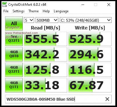

My SSD benchmark test is as follows:
Based on this, I doubt that SSD speed is an issue - it is going like a rocket!

Normal results for a good SSD, the only time the SSD becomes a bottle neck is when transferring / writing lots of small files of a few KB long or less, try copying a really big browser cache with hundreds of very small files to see the effect.
That's the main difference in performance results between various SSD technology and price.
