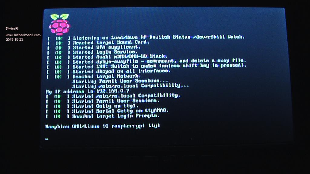

If this works it is a photo of my RPI ZERO driving a $50 7in truck rear view display.
The text is more readable than the photo indicates but is not perfect. It's like my writing, if you know what it says you can read it.
How do you photograph these things?
I still can't get mmbasic to work but the display does work and that is what I set out to prove/disprove.
