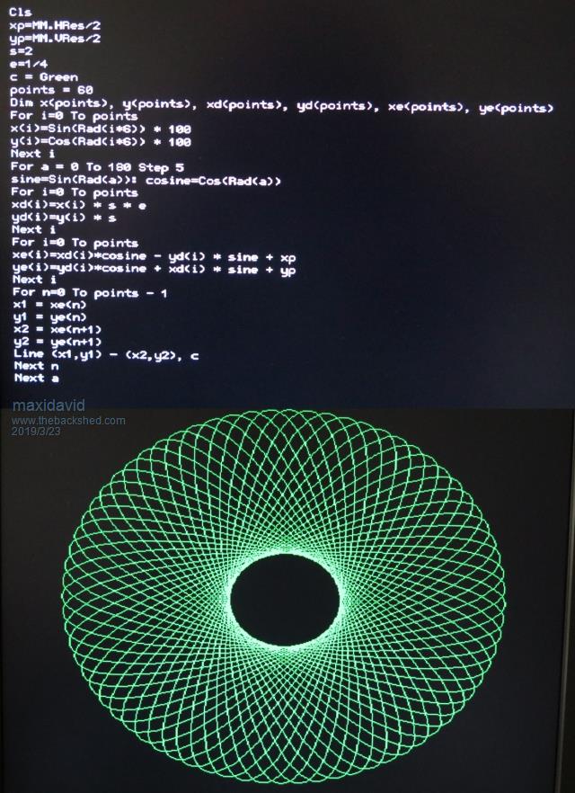

maxidavid
Joined: 07/03/2019
Posts: 23
Posted: 02:51am 23 Mar 2019
Hi,
I had a play with Peters program:
Edited by maxidavid 2019-03-25
