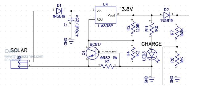

As mentioned in earlier posts I have some MMs radio connected in a star network for in-field data collection. I have been using 12 Volt SLA batteries that are charged by a 10W solar panel. I have been experiencing battery failure which I believe is caused by evaporation of the fluid in the SLA batteries due to consistent dry and hot temperatures. I have been considering using Li-Ion batteries (3*3000mAh) to replace the SLA batteries but I am worried if my simple charging cct can be utilised without too much butchery to the PCB's.
Here is the circuit I am currently using:
Firstly R4 and R2 set the voltage presented to the battery (allowing for D2).
Charging current is limited by the transistor turning on and Imax can be adjusted with the value of R1.
Any discussion appreciated.

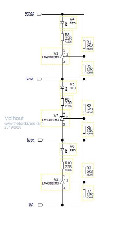

Please be aware that a 3 cell lithium ion battery will require a balancer.
Even if the cells are matched to 1% of their capacity, your solar charger will charge them every day (*). Within a year the unbalance will destroy cells.

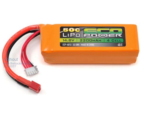

A balancer is not a big complex circuit as long as the capacitance of the batteries is low, but or 3000mA (do you actually need that much to survive the night ?). Here is a picture of a 3S balancer I use for my model airplanes.
From looking at your circuit diagram your charger will charge with 750mA max (that is perfectly fine for 3000mA LiPo). The voltage should change from 13.8V to 12.6V for 3 cell LiPo (3 x 4.2V). Change R4 from 1.2K to 1.1K (1.08k would be optimal, but 1.1K allows for 0.2V drop across D2).
