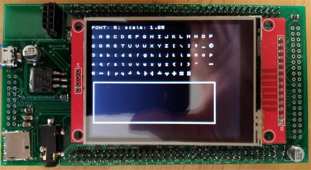

Following up on matherp's micro-font thread which I pretty much hijacked, here is an 8x8 font with the single-line "box drawing" graphics characters based on those of the old IBM PC Code Page 437 encoding.
Below is the program which drew that screen, including the font definition. I placed the characters not where they are on Code Page 437, but right above the normal ascii characters, positions 128-139 (&h80-&h8B).
As I said in the other thread, it may seem silly to want these characters on a device which has the true graphics ability of the micromite, but I had a use for them, it familiarized me to a degree with how fonts are defined in MMBasic, and I had fun. What more can you ask?

Corrected because I had horizontal uptic and downtic wrong. Also added "+". Code has been corrected in first post, but CG was too quick for me to get the photo corrected.
(Note that "Scale" in the photo is not effective--only values 1-15 are allowed.)

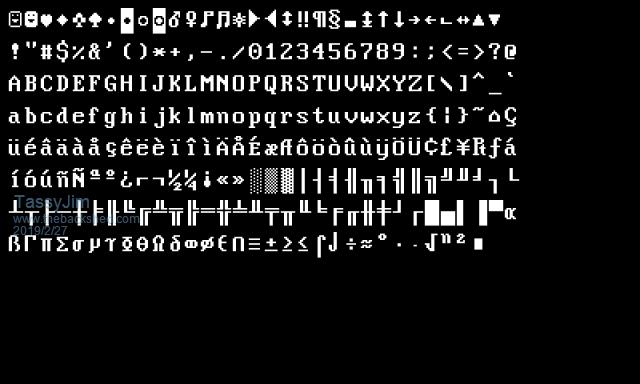

4 more line drawing fonts
These are all the upper 127 characters of the IBM fonts.
Sizes are 8x8, 8x14, 8x16, 9x16

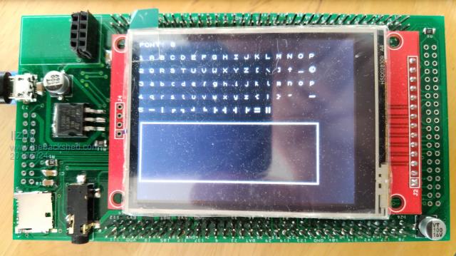

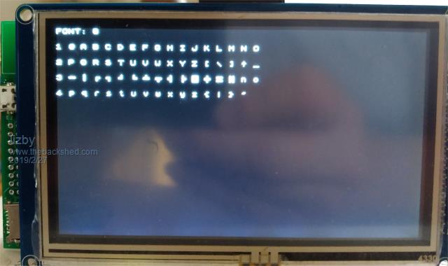

I ran into various problems with the PC drawing characters at positions above 0x7f--immediately above there some were "magic" characters, so that when I downloaded them, "AUTOSAVE" and "RUN" were invoked. I moved them up 32 positions and still had trouble reading them into an mmbasic program from a file, or inserting strings of them as CONST statements.
My solution was to move them down to the lower case ascii slots, specifically 0x60-0x6e. This eliminates those lower case characters, but they are available by using another 8x8 font. I also added the block character--all bits are 1.
Sorry for the blurryness of the photo. The display itself, a 4.3" SSD1963 on a Nucleo H7 backpack, is quite crisp.

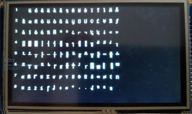

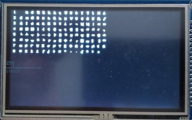

Thanks for those fonts, Jim. For display purposes, I replaced the first character with a space (all zeros). Here's the 8x8 font.
The program:

The 9x16:
[code]
dim string A
dim integer i,j,k,ifont,iStep,nLines,vLoc
cls
ifont=8
font 8
print "font ";ifont;": ";mm.fontheight;" ";mm.fontwidth
for k = 1 to 8
A=str$(k,2,0)+" "
print A
text 0,vLoc,A,L,7,,rgb(white)
A=""
for i = 1 to 16 : A = A + chr$((k-1)*16 + i) + chr$(1) : next i
text mm.fontwidth*3,vLoc,A,L,ifont,,rgb(white)
vLoc=vLoc+mm.fontheight*2
next k

Posted: 11:43pm 26 Feb 2019
I thought I would try a font with 254 characters. I wasn't sure if ewe could go above chr$(127). We can.
dim integer x,y,k
cls
font 8
for k = 1 to 255
x = ((k-1) mod 32) * 20 + 20
y = int((k-1) / 32) * 40 + 10
text x,y,chr$(k),c,8,2
next k
save image "Fonts.bmp"

E0830D1B 0000F801 00000000 00000000 0D1B1C00 F0018083 00000000 00000000
00000000 0100060C C0C0C080 808F3163 00000000 00000000 F9030000 3060C080
00000000 00000000 00000000 060CF803 00800103 00000000 18306000 6060664C
26676060 F8C0C0C0 60000000 664C1830 66606060 C0872567 00003060 03060000
60C00000 0F1E3C30 00000003 00000000 01000000 6CB0B1B1 0000001B 00000000
00000000 B0C10600 006C6C6C 00000000 22110000 12814804 11884420 81480422
88442012 55155555 55515545 15555554 51554555 3BDD5455 D3ED4EB7 DDEE74BB
ED4EB73B EE74BBD3 03060C18 60C08001 060C1830 C0800103 0C183060 80010306
18F061C0 0103060C 3060C080 03060C18 61C08701 060C18F0 C0800103 1B363060
61C3860D 36ECD9B0 C3860D1B 6CD8B061 00000000 01000000 0D1B36FC B061C386
00006CD8 07000000 18F061C0 0103060C 3060C080 860D1B36 19B067C3 0D1B36EC
B061C386 1B366CD8 61C3860D 366CD8B0 C3860D1B 6CD8B061 00000000 19F00700
0D1B36EC B061C386 1B366CD8 67C3860D 00FC19B0 00000000 00000000 860D1B36
D9B061C3 000000FC 00000000 0C180000 87010306 00F061C0 00000000 00000000
00000000 01000000 060C18F0 C0800103 0C183060 80010306 003F60C0 00000000
00000000 03060C18 61C08001 000000FF 00000000 00000000 00000000 18FF0100
0103060C 3060C080 03060C18 60C08001 060C183F C0800103 00003060 00000000
00FF0100 00000000 00000000 03060C18 61C08001 060C18FF C0800103 0C183060
80010306 183F60FC 0103060C 3060C080 860D1B36 D8B061C3 0D1B366F B061C386
1B366CD8 61C3860D 007FC0BC 00000000 00000000 00000000 C0FC0100 0D1B366F
B061C386 1B366CD8 67C3860D 00FF01BC 00000000 00000000 00000000 01FC0700
0D1B36EF B061C386 1B366CD8 61C3860D 366FC0BC C3860D1B 6CD8B061 00000000
01FC0700 000000FF 00000000 1B360000 67C3860D 36EF01BC C3860D1B 6CD8B061
03060C18 01FC8701 000000FF 00000000 1B360000 61C3860D 00FFD9B0 00000000
00000000 00000000 01FC0700 060C18FF C0800103 00003060 00000000 36FF0100
C3860D1B 6CD8B061 860D1B36 D8B061C3 0000007F 00000000 0C180000 80010306
003F60FC 00000000 00000000 00000000 60FC0000 060C183F C0800103 00003060
00000000 367F0000 C3860D1B 6CD8B061 860D1B36 D9B061C3 0D1B36FF B061C386
0C186CD8 87010306 18FF61FC 0103060C 3060C080 03060C18 61C08001 000000F0
00000000 00000000 00000000 183F0000 0103060C 3060C080 FFFFFFFF FFFFFFFF
FFFFFFFF FFFFFFFF 0000FFFF 00000000 FFFF0100 FFFFFFFF FFFFFFFF 1E3C78F0
C183070F 3C78F0E0 83070F1E 870FE0C1 F8F0E1C3 0F1F3E7C F0E1C387 1F3E7CF8
FFFFFFFF FEFFFFFF 00000000 00000000 00000000 03000000 D8B071B3 C00E376C
00000000 191E0000 6163C68C 3163C698 00008099 00000000 66CC983F C0800103
00183060 00000000 00000000 B061E30F 1B366CD8 0000800D 00000000 63CC1F00
3030C000 C09F3130 00000000 00000000 61F30300 366CD8B0 0000000E 00000000
63060000 66CC9831 0C0C183E 00000000 00000000 60E06607 060C1830 00000003
00000000 81C10F00 66CC98E1 C00F061E 00000000 07000000 1933C606 1B63C6FC
00000007 00000000 668C0D0E 6CD81833 C01D1B36 00000000 86070000 F8608001
193366CC 00008087 00000000 03000000 DBB66DF3 0000003F 00000000 00000000
6DF36360 183FF3B6 00000018 00000000 03060607 60C0F001 80030C30 00000000
0F000000 1933668C 3163C68C 0000C098 00000000 E00F0000 00FC0100 00803F00
00000000 00000000 F8C18001 00001830 0000E01F 00000000 80010600 18181860
C00F0018 00000000 01000000 80818181 00061860 0000C00F 00000000 B0618303
183060C0 0103060C 3060C080 03060C18 60C08001 366CD830 0000000E 00000000
80010000 00FC00C0 0000060C 00000000 00000000 70B30300 006E7600 00000000
1C000000 80830D1B 00000000 00000000 00000000 00000000 00000000 00001830
00000000 00000000 00000000 18000000 00000000 00000000 01830700 3160C080
0F366CD8 00008003 6C000000 C3860D1B 0000B061 00000000 00000000 06363800
E0430606 00000000 00000000 00000000 C3070000 7CF8F0E1 00001F3E 00000000
00000000
End DefineFont
The results:
  Quote  I ran into various problems with the PC drawing characters at positions above 0x7f--immediately above there some were "magic" characters, so that when I downloaded them, "AUTOSAVE" and "RUN" were invoked.
There will be problems with chr$(3) and chr$(26) if you embed them directly into a string and try to use AUTOSAVE. Others might also be trouble. Theer shouldn't be an issue if you upload using XMODEM
There is no problem printing them.
The above test was on an Armite H7 with 5inch display.
Posted: 11:57pm 26 Feb 2019
No problem printing characters above 0x7f, but I had varying problems downloading them with AUTOSAVE or after downloading them in strings with XMODEM, printing them.
Posts: 2554
Posted: 01:38am 27 Feb 2019
you'll find that AUTOSAVE clears the top bit on all incoming characters, while the micromite's built-in editor just fails to cope with the top bit being set.
see this thread for discussion:
https://www.thebackshed.com/forum/forum_posts.asp?TID=11139
rob :-)
Posted: 04:41am 27 Feb 2019
Characters above 0x7f will also get caught up with the ASCII/UTF8/Unicode translation problems.
