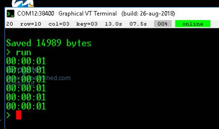

PRINT Time$ added to DO/LOOP - never makes it past 00:00:01
CTRL-C break, then ? Time$ - 00:00:06, so the RTC is ticking again, but only AFTER you CTRL-C break the running code - inside a loop which, does not clear the RTC, so it SHOULD be ticking....
I will now try the T$ idea.

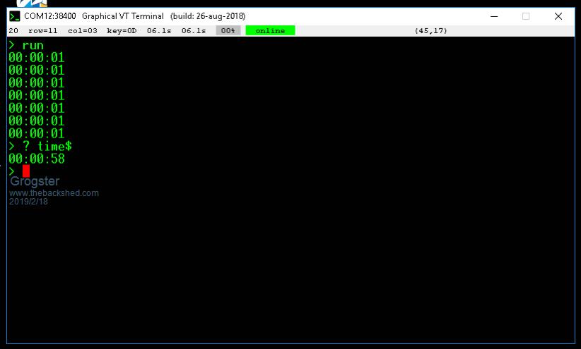

EDIT: Results from adding a 'PRINT Time$' to the loop:

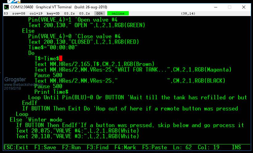

Results of saving Time$ to T$ first is EXACTLY the same - the RTC never moves.
The extra code I added was: T$=Time$ which is now the first line in the DO/LOOP with the blinking tank message:
EDIT: Run the code for 7 seconds, RTC never moves past 1s. CTRL-C break, wait a little, ask for the time$:
This is really odd..... Edited by Grogster 2019-02-19

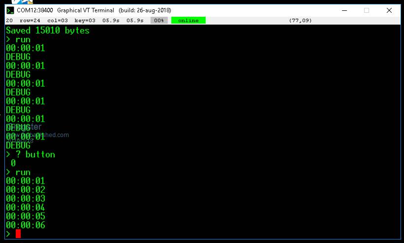

I added a PRINT "DEBUG" right after LOOP UNTIL PIN(BLU)=0 OR BUTTON line.
This resulted in the above readout.
If everything was working correctly, I should NOT get the debug messages, but I was.
This revealed all.
PIN(BLU) is the top-level tank sensor. It HAS to be out of water(and therefore zero), but I have a hardware short on that one for now to simulate a full tank. Naturally, you can't have the lower sensor out of water at the same time as the upper one IN water, so what was happening, was that the OR operator on the LOOP UNTIL PIN(BLU) OR BUTTON line, was seeing that the top-level sensor was now under water, so it was then looping, and it comes around the same loop again, and falls over itself.
As soon as I removed the hardware short on the BLU input, the problem went away, and the timer now works.
