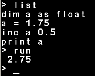

  stanleyella said  inc is ok. what if it's float?
Easy enough to test:
Posted: 12:48am 20 Jan 2024
  Turbo46 said  Easy enough to test:
You get a more reasonable result of 2.25 if you include the comma before 0.5

Posted: 01:05am 20 Jan 2024
Doh! Thanks Lizby without the comma it is just incrementing by one and ignoring the 0.5. I wasn't paying proper attention.
