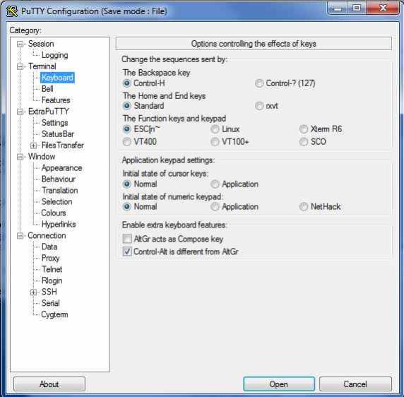

Failing that, here is the keyboard config from the session - I am hoping this will set your F keys correctly

You should left click in the putty console screen, then F10, then right-click the console screen - I think this is what you meant but just checking.
What speed is the MM running at? It will need time to process the input and if you are throwing stuff at it at 115K with CPU 10 or some such combination it might struggle. I have tended to standardize on CPU 48 and 9600 baud on everything (old tricks I guess plus HC-12's like it for maximum range so it's just a nice figure), but the default of 38400 transfers perfectly. I don't use any flow control.
Also, what usb<-->serial adapter are you using? I use CH340G throughout (got fed up with inconsistencies in drivers of the FTDI & Prolific) and I find them pretty bomb-proof... even better at 99p a pop. But, I also transfer flawlessly as above on one of WW's 44Pin Mk2s (my main breadboard/dev MM) so whichever chip that uses is good too.
I must say that during the AUTOSAVE transfer, the console screen doesn't always reflect the transferred data (leading spaces are particularly truncated) but the transfer is good and listing afterwards shows it is faithful to the editor copy. I have never had any problems transferring this way except from the USB terminal app on my phone - but that it not a major route for me so I am ok with not being able to upload that way. It would be a novelty if it worked but I can live without it.Edited by CaptainBoing 2018-10-15
