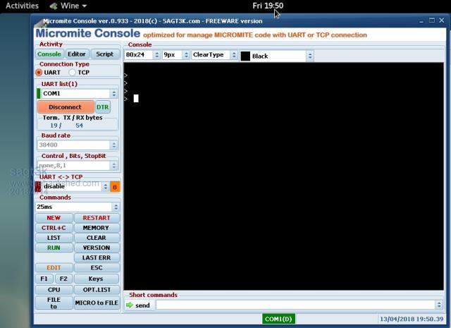

Posted: 02:49pm 13 Apr 2018
The baud rate is set to 38400, which works for the other programs.
I've attached a screenshot for you.

SteveA
Joined: 10/03/2017
Posts: 49
Posted: 05:51pm 13 Apr 2018
Yes, all the programs show two ports.
COM1 for the MM with serial to usb adaptor.
COM5 for the MM+.
I can click on connect and disconnect and your program responds, the boxes change between red and green, and a message at the bottom of the window confirms the connection etc.
But, if I type a 'short command' list or memory for example, and click on 'send' nothing happens. The TX/RX counts don't increase, and I don't even get any garbage in the console window.

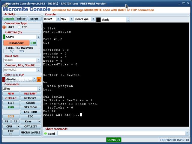

I follow your indication, here the result:
... and I try to do CTRL+C ... and prompt is ready !!
SteveA
Joined: 10/03/2017
Posts: 49
Posted: 02:51pm 16 Apr 2018
I now have MicromiteCons working, see the screenshot below:
It wouldn't run on Wine v1.6.2, but it will under v3.0.
