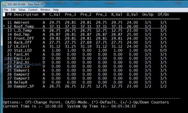

If you want to get brave you can add multiple DS18B20's onto a single cable.
I've mentioned it in some other threads.
One of my projects has 5 & the other 7. All daisy chained together.
Makes life a whole lot easier not having to run 7 cables up into the roof & to each room.
Just have a flat telephone cable with droppers.
Total run length is about 30m.
Phil.

Posted: 11:33pm 19 Mar 2018
Interesting. I'd kind of like to understand what you mean by daisy chained, and how a single MM pin can deal with multiple sensors. Even if I am not understanding it correctly I do like what you've done and would like to know more.
