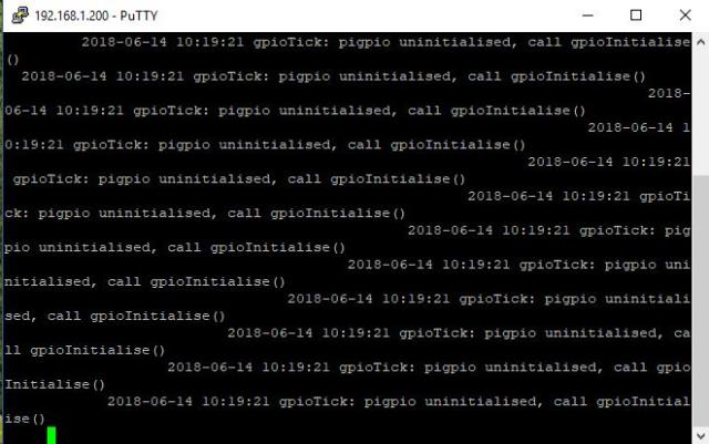

Posted: 10:23am 14 Jun 2018
Peter
There's still one bug that's causing the scrolling display
I tested the Pi the other day and left it connected to the power
today I connected to the Pi
ran sudo ./mmbasic
I go the scrolling text
Would it be because mmbasic was already running on the Pi and when I try and run it again it's doing this?
Posts: 12084
Posted: 10:35am 14 Jun 2018
  Quote  Would it be because mmbasic was already running on the Pi and when I try and run it again it's doing this?
Yes. You should always exit the Pi-cromite application (ctrl-Z) before disconnecting the terminal. There is a way of connecting the Pi-cromite application to a pseudo-terminal such that you can then re-connect to the same instance later. Details for this were supplied buy another TBS member and are buried somewhere in the original very long Pi-cromite thread

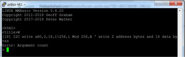

Posted: 01:56am 12 Jul 2018
I'm trying to write to a 24LC64 eeprom with Pi-cromite mmbasic on a pi zero w.
I don't clearly see how to specify the address to be written, but in this thread, grogster, et. al., put in the address bytes before the bytes to be written:
Dim A=1 'Address byte
I2C WRITE &B1010000,0,6,A\256,A Mod 256,B,C,D,E 'Write four bytes from address 1
I'm trying to write a 4K+ character file with this code.
[code]
' write 24LC64 eeprom
' option i2c 3,5 ' not valid within a program
open "watermon_chart.html.template" for input as 1
dim as string A
dim as integer i = 0, iflag = 0
CONST cFE=chr$(254)
CONST cFF=chr$(255)
i2c open 100,100
do
A = input$(16,1)
? A
if len(A) <> 16 then
A = A + cFE + cFE + cFE + cFE + cFE + cFE + cFE + cFE + cFE + cFE + cFE + cFE + cFE + cFE + cFE + cFE
A = mid$(A,1,16) ' truncate to 16 characters
iflag = 1
endif
i2c write &H50,0,18,i\256,i Mod 256,A ' write 2 address bytes and 16 data bytes
Pause 10 'make sure EEPROM has time to write(5ms needed)
i = i + len(A)
if iflag = 1 then
exit
endif
loop
close 1
? i
[/code]
I'm reading (and writing) 16 bytes at a time, and if the last read is less than 16 bytes, filling in with 0xFE.
The error message on the first write says "Error: Argument count".
(I had to enter "OPTION I2C 3,5" at an MMBASIC ">" prompt to get past an objection that the I2C pins weren't defined--are all pins available with picromite i2c?)
How do I specify an address to be written for the eeprom?
Posts: 12084
Posted: 07:10am 12 Jul 2018
  Quote  The error message on the first write says "Error: Argument count".
Your syntax is incorrect - check the Micromite manual Appendix B. You can either have a list of single variables or an array/string not both.
  Quote  (I had to enter "OPTION I2C 3,5" at an MMBASIC ">" prompt to get past an objection that the I2C pins weren't defined--are all pins available with picromite i2c?)
Yes, the I/F is bitbanged as the Pi has known issues with clock stretching and the bitbang code does this properly
Posted: 12:11pm 12 Jul 2018
Thank you. This worked:
A = chr$(i\256)+chr$(i Mod 256)+A
i2c write &H50,0,18,A ' write 2 address bytes and 16 data bytes
4144 bytes written.
At long last: a convenient way to write bulk data to an 8-pin eeprom.
