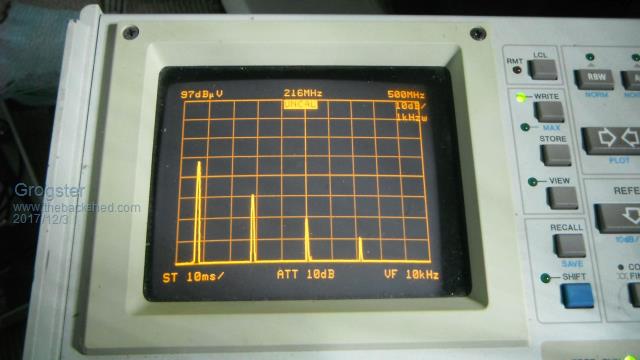

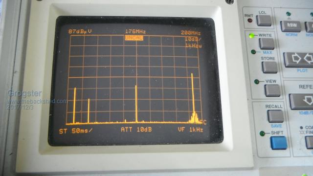

Testing an FM transmitter today. Output is set for 1W into dummy load, with spectrum analyser looking at it.
Check this out:
Centre frequency is 176MHz, and is looking at the 2nd harmonic of the carrier frequency which is 88MHz. No modulation, just "Dead-air" carrier.
2nd Harmonic is about 2dB UP on the carrier, and check out that 3rd harmonic at 264MHz! It is about 12dB UP on the carrier - bloody hell - with some kind of spurious signals hanging around either side of it. Nasty.....
This is non-compliant in it's current state. The on-board filter is supposed to be broadband, but it obviously is not. If I reset the output frequency to 108MHz with same 1W output power, the harmonics are much more in line with what I would like to be seeing on the spectrum analyser, although still peaking higher then I would like to see:(2nd is 10dB down, 3rd is 20dB down - more in line with how it should be)
So the on-board filter is obviously designed to favour the upper-end of the FM band, so adding an additional LFP should clean it up enough to use, but not one to put on-air on the low-end of the FM band, that's for sure!!!

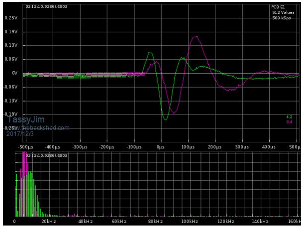

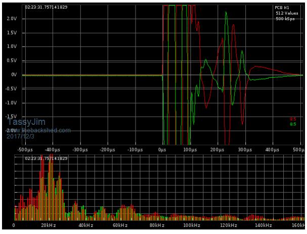

That's not harmonics, this is harmonics:
Electric fence unit
A 'good' fence looks like this
Posts: 10076
Posted: 04:08am 03 Dec 2017
Crikey!
Other members feel free to post your nasty scope/analyser shots.
