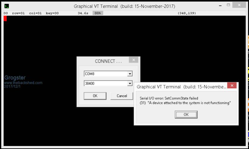

Hi there.
Rob - I get this odd error when I connect a VT100 terminal(Geoff's MX250 one) to GFXterm:
TeraTerm talks just fine to it on COM8, but If I close TT(leaving VT100 connected), and try to connect via GFXterm, I get that error every time. Close GFXterm, reopen TeraTerm, connect to COM8 - away I go no problems.
Any reason why that should be?
I don't care - I was only playing with the VT100 board tonight for something.
Just thought I would report it.

Posted: 07:46am 02 Dec 2017
an interesting error, if i had the hardware here i could run GFXterm from the delphi IDE and inspect the data passing back and forth between GFXterm and windows while the port is being opened.
comm port names are obtained directly from the windows registry, so there are no limits on the port number - indeed, the name does not even need to be in the form of "com<n>", it simply has to match one of the registry enteries under the list of active serial comm ports.
the sequence of win32 API calls for opening and configuring the comm port is then:
1. CreateFile: this converts the ascii port name into a 32-bit numeric handle and opens that handle. this is the only part that uses the ascii name.
2. SetupComm: configures the size of window's internal read and write buffers associated with the port's handle.
3. GetCommState: retrieves from windows the port's current configuration into a DCB (device control block) structure.
4. BuildCommDCB: modifies the DCB using the string "baud=38400 parity=n data=8 stop=1" (or whatever other baud rate you have entered).
5. SetCommState: sends the modified DCB back to the driver controlling the port.
6. SetCommTimeouts: adjusts read/write timeouts.
while you're seeing the failure at step 5. SetCommState, i bet the problem is actually with GetCommState returning invalid data in the DCB. examining the DCB while GFXterm is running within the IDE would show the corrupt entries. or i could compile a 'special' version that displays the DCB, but that would be more difficult!
rob :-)

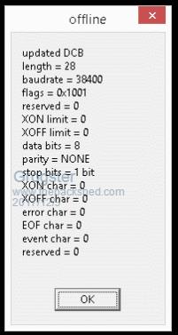

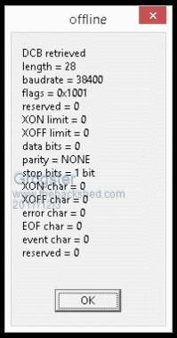

Posted: 11:31am 02 Dec 2017
give this test version a try:
2017-12-02_212819_GFXterm_TEXTD.zip
it should pop up a couple of dialogs, the first showing the DCB retrieved, the second showing the DCB that it is about to try and save. if you can grab an image of each one, it should provide a few clues about what is going on.
rob :-)

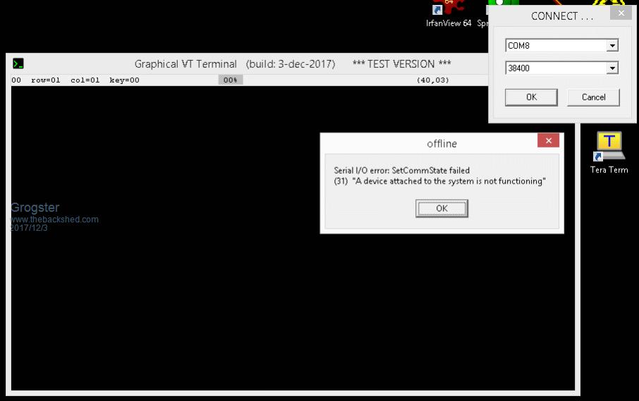

Posted: 02:18am 03 Dec 2017
Howdy.
As requested:
Posted: 11:56pm 03 Dec 2017
right, give this test version a spin:
2017-12-04_095036_GFXterm_TEST_version_E.zip
you'll still see an error, but have the option of ignoring it. tassyjim sent me some info that allowed unravelling the mystery a little more - it looks like there is/was a bug in the microchip USB stack, and that teraterm (rather naughtily) silently ignores the resulting error returned by windows.
rob :-)

  robert.rozee said   right, give this test version a spin:
rob :-)
THIS ONE WORKS FINE.
I get the error as you said, but I click on IGNORE, and the VT100 terminal is accessible just fine after that. I even connected a MM to it, and can still talk to it fine.
