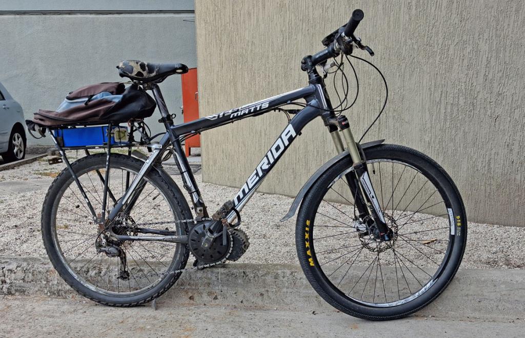

the first battery was $450, 20Ah 48V nominal LiPo, 13S5P 18650 cells with BMS
I got it back during Covid19, maybe 2021..
I rode 29,400km on it, with an average depth of discharge leaving 65 - 70% capacity remaining.
nearly all rides were the 26km ride to work, same distance back to home.
I have charges both at work and at home.
motor is a Bafang 1500W, I use output current levels of 12A and for a few minutes 15A
29,400/26 = 1130 trips or discharge/recharge cycles
average discharge maybe 32% over this lifetime
0.32 x 20Ah = 6.4 Ah capacity used.
voltage drops during the ride, from 54V at the start to 50V at the destination (when new) and 54 to 48 now.
I say it spends most time at 50V on average during the ride.
ride time is about 80 minutes.
6.5 Ah x 50V = 320 w.hr
total energy taken out of the battery now becomes
320W.hr x 1130 = 361 kW.hr
petrol contains 34 MJ of energy.
1 kW.hr = 3.6MJ
so the energy taken out of the battery is equivalent to
361 * 3.6 / 34 = 38
38 Litres of petrol.
Recently I bought a "21Ah" 48V battery, costing $445 delivered
to replace the one discussed above.
The first ride to work had the battery arrive with 52.3V
and that is ridiculous, it implies I used only 10% of the capacity.
The next few weeks will be interesting to see this voltage change to something
more reasonable like 51V or 50.5V
I have put 4 chains, 3 front chainwheels, 2 9-speed cassettes, 4+ sets of brake pads,
3-4 sets of tyres on it.

I think making the e-bike has been pivotal in my recent life and I doubt I would be
here now without it.

How do you get away with having a 1500 watt motor on the e bike.
I thought that the limit was 250 watts. But then I guess not many folk can tell the difference

the 1500W motor looks like the 250W only a bit bigger.
I think what works best for this problem is not going much faster than 25km/h
and not riding like a 15 year old with a bad attitude that needs adjusting with
a clip over the ear and using bike/walking trails if available.
