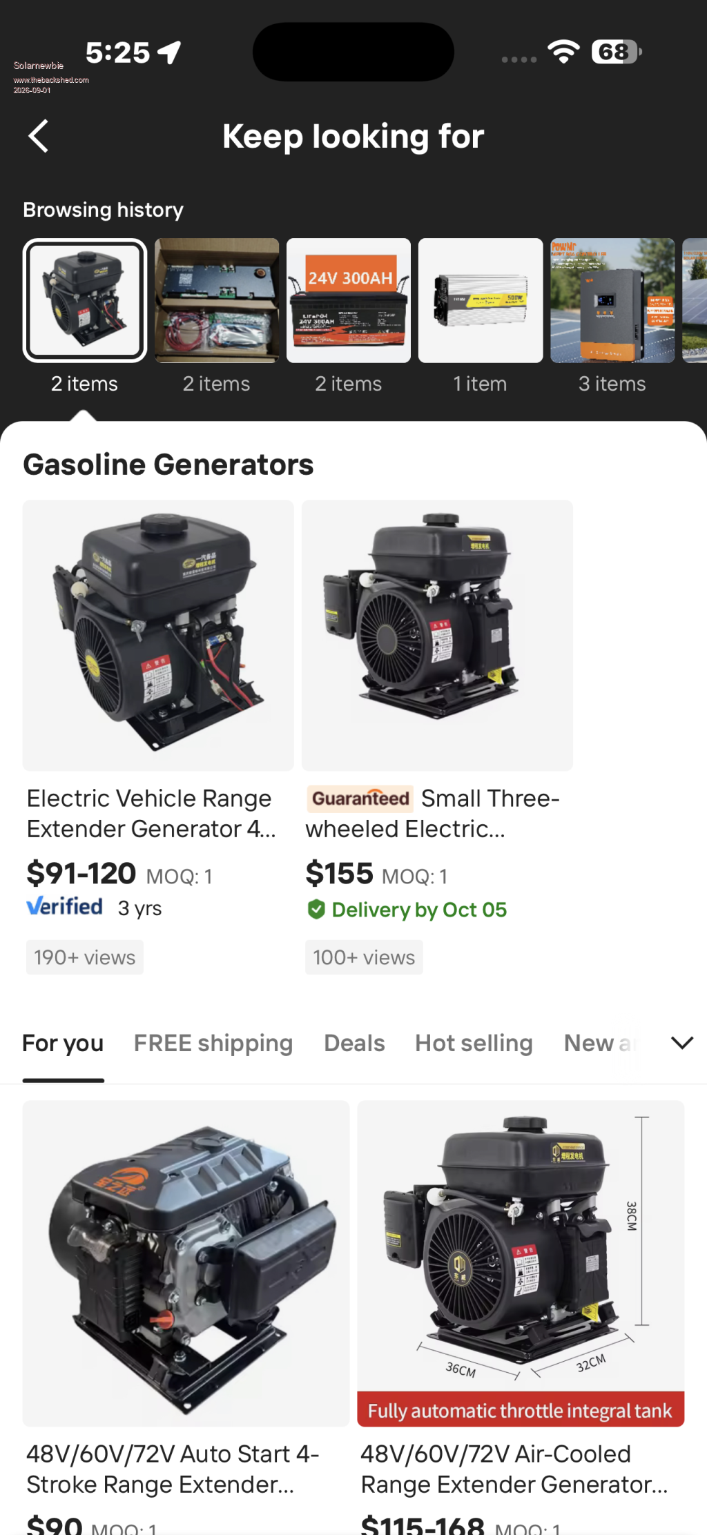

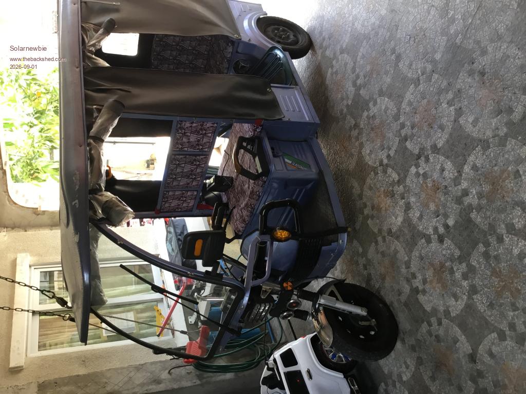

Posted: 09:28am 01 Sep 2026
Thought you might appreciate this. I’ve got one I used for solar but it’s not needed now so I added it to my E-Trike. My E-Trime is 48v 100ah but really don’t like getting stuck too far from home and can now go further.
