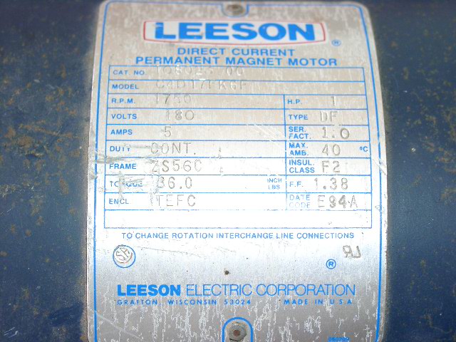

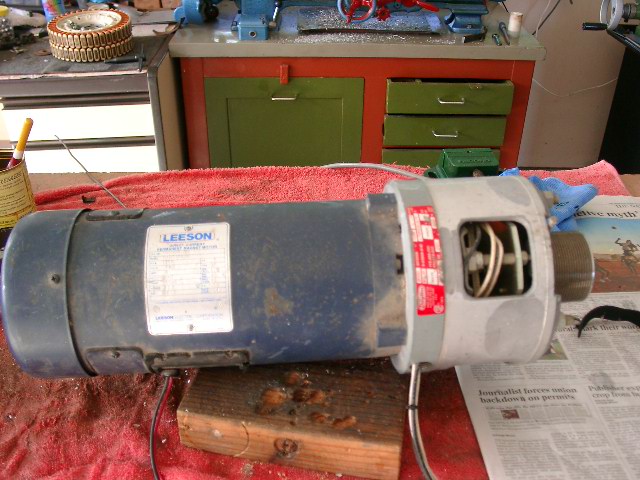

yesterday , I scored a 1 HP dc (180V ) Leeson motor and electric brake -looks in perfect condition--now there's a possibility ---

The motor might be useful with a gearbox. This will be a brush motor with a wound rotor with commutator. This would be very useful as the motor powering your test setup. I would make up a 5 to 1 reduction drive with a cog belt etc. The power supply would be a 500W, 110V isolation transformer with rectified output. A decent filter cap to smooth the DC. A simple PWM mosfet chopper with a LC filter and freewheeling diode on the motor. I used a similar cct for the drive on a solar car. This would provide an infinitely variable speed control to the motor. The input power is easily measured. The efficiency of this motor would be superior to a squirrel cage induction motor. The power in v output could be more easily compared for many different setups. You may wish to discuss this further.

The Dc motor will work but being permanent magnet I would earmark it for generator projects. A AC universal motor , old skill saw drill etc would work just as well in fact price new no need for old. Can run them on a reduced DC voltage that can be varied by electronic,resistive, or best variable voltage transformr .
Dc eliminates pf in current measurement but still loads inaccuracies use torgue to measure input
