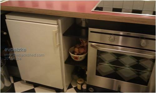

Reducing energy consumption down to the half by insulating my old fridge with polystyrene foam (styrofoam).
I did insulate my old Siemens fridge bought in 1993. It did cost me 25 Euros in material. After one year i will get that money back because of saving costs for power. After that I save 27 Euros per year. Baseline power consumption was 247kWh. I did reduce it down to 128kWh.
My essential steps:
Insulating all possible walls with foamed polysterene at least 2cm thick except the door with 1cm. I put the insulation either on the outside or inside wall depending on what seemed more reasonable.
Decorating the outer polysterene with self-adhesive films
Adjusting the thermostat, cause it did cool too much for that new efficient insulation even when it was turned down as much as possible. I had to open the thermostat and adjust it with a screw inside.

you are right of course. But even the new fridges dont reach very far what matters to efficiency. They still use 90kWh per year. But the best freezer which keeps a temperature of minus 18°C inside and not only plus 5 or so only uses 130kWh a year. I calculated that if you regulate such an efficient freezer with a fridges thermostat it would consume only 30-40kWh per year. That is a project i really would like to realize one day.
But that calculation shows that companies do build what sells. People buy elegant fridges with much space inside and as little space as possible outside - means thin wallse. My freezer-to-fridge-project would produce thicker walls.
