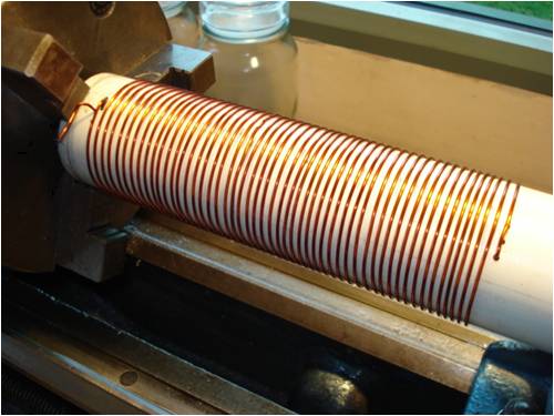

had ago at winding a radio coil.

Nice job Bruce. Whats it for, a crystal set?

You may ge able to wind the wire more accurately by first cutting a thread slot into the former first. I am not sure if your lathe has thread cutting facilities.

I used to feed a length of string beside the wire, to give a even spacing. Then unwind the string once the wire was secured. A little varnish will hold it all in place.

I to had built one back in high school, I remember winding the wire around a piece of PVC pipe, we put a twist in the wire every so many turns to give different tap points for the coil.
