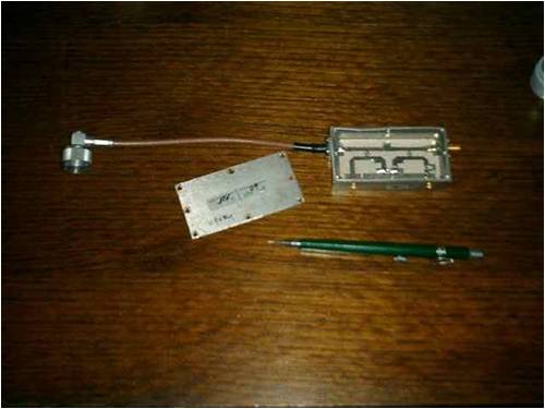

Edit: once had the privilege of playing around with a 7.5m parabolic antenna (ex-WW2 German radar: http://en.wikipedia.org/wiki/W%C3%BCrzburg_radar)for solar noise measurements; I can't help but wonder how many bars of signal strength you could get with one of those....) Edited by Dinges 2009-09-18

Dave, I don't know more measured results than what I put on the label - long story... :( I spent about an evening measuring it in any possible way with a friend who had borrowed a networkanalyzer from his work for the evening. I made only very few notes myself that evening, as the analyzer had storage capacity and could print very sexy graphs when hooked up to a PC. When the analyzer was returned to his work, another colleague used it and removed all data. ARGH! An entire evening gone to waste. All I know now about it is the insertion loss at those two frequencies. What I do recall was that it performed generally very well in all respects up to 1000 MHz, and very usable up to 1300 MHz (23cm band).
The optimizing was done by the original manufacturer by adding bits of foil, scraping away pads, making cuts, etc.etc. They didn't spare time or effort trying to get the best results out of it. Another reason why I generally love ex-telecom stuff.... built to high standards.

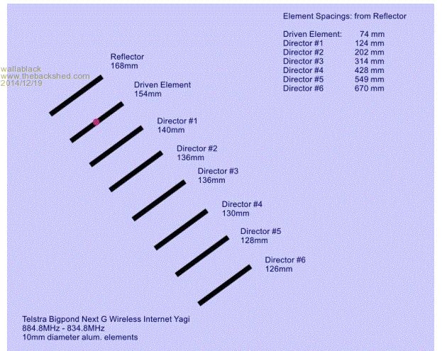

I followed the measurements as close as I could, I'm confident its all within .25mm. I started my apprenticship as a radio technician, and it was fun to dabble in aerials again after so many years. I have a couple of satelite dishes just begging to be experimented with WiFi.

All the lengths and spacing between the two halves were measured with my trusty old verniers.
The dimentions are in the link in the first post.

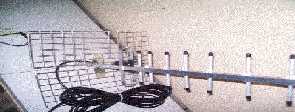

Stumbled across this doing a Google Image search for Yagi's.
I am just about to build one myself as our internet reception here is woeful. We have a tower on the hill behind us but the signal shoots straight over our place.
Thanks for posting this one.
