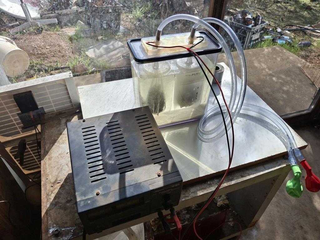

          A few weeks ago a mate showed me a youtube on water splitting which has been on my mind ever since. Now there are plenty of ways to go about this where a single outlet will give you HHO which is a very volatile mix to say the least.
So doing this on a budget where I found some whisks for $1.50 which sit inside a couple of soda water bottles and have a SS scrubber in each whisk and with the bases of the soda water bottles cut off the electrical contact can happen under the bottles.
Finally went on ebay agian to buy a 32 volt 10 amp lab power supply and sure enough the seller changed my order to a 120 volt 3 amp lab power supply. I messaged the seller within 5 minutes when I noticed the error and the next morning got a reply saying my order was corrected. Now as the 120 volt was around $30 dearer it will be interesting to see if a credit or refund is there but I doubt it. So I will get onto that after the unit arrives.
From the video I did watch he went from zero volt to around 6 volts for a 10 amp output now the whole point of this exercise is to power this straight off a solar panel where I just happen to have a spare 330 watt panel for the project.
This morning I assembled the unit and siliconed the top to keep the wires in place and seal the outlet so pic's can come in the next few days.

           Well finally got it all setup and going
I made a saturated solution of baking soda and used my 30 volt 3 amp old power supply and finding it does keep going into current limit.
At first saw no action on the ballons so siliconed up around the tubes and cut some short lengths of 10 and 12mm tube pushed them together and now the ballons are a tight fit and found pretty well straight away they popped out so they are filling slowly

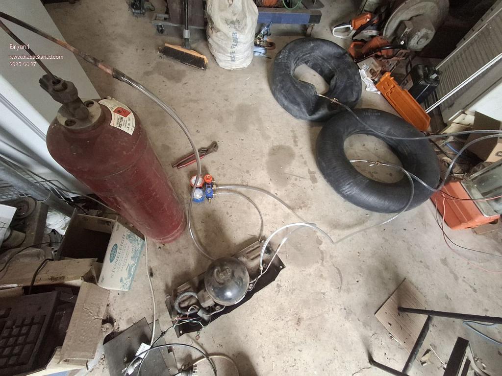

Pete I silver soldered some 5/16" copper tube onto 2 of those brass valves I had here so each arvo after a days run I can shut the valve to keep the gas.
I still need to setup my old fridge compressor to accept the 8mm plastic tubing and put in a pressure gauge as knowing what pressure is there is needed.

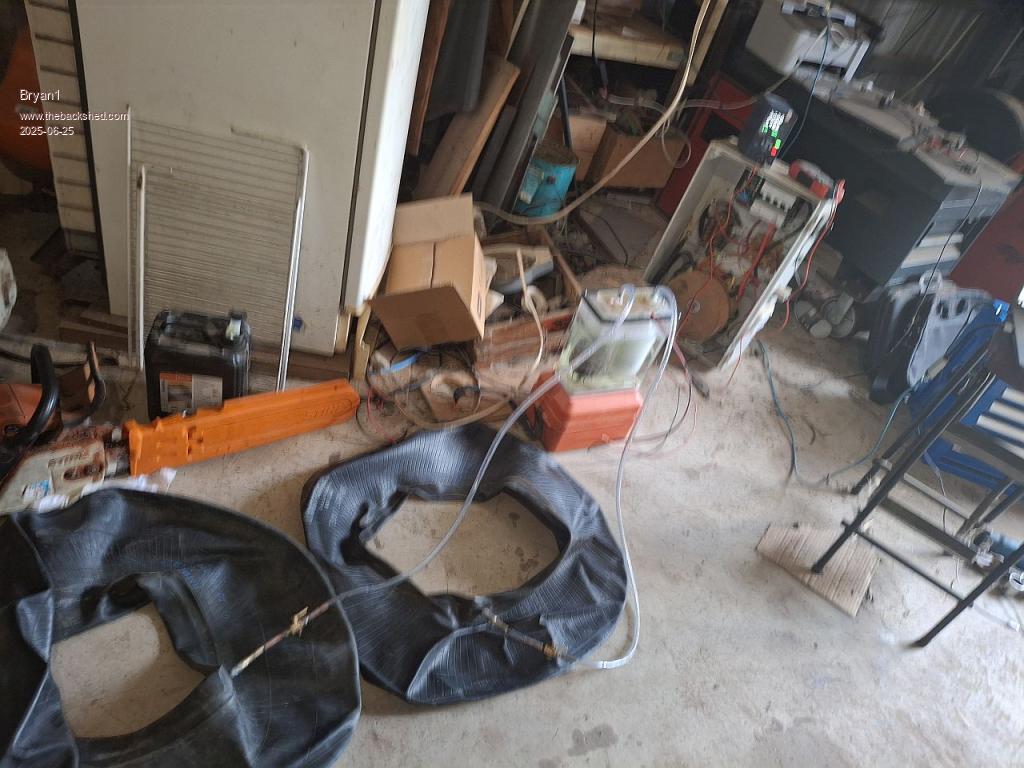

Yesterday machined up the fittings for the tubes so now the job getting everything hooked up and letting the fun start.
Cheers Bryan
Edit: Ok vacuumed out the tubes and got it all setup and going
Set the power supply to 32 volts and it's drawing 5.861 amps and slowly the amps are raising so it does look like this setup will be suitable for the solar panel.

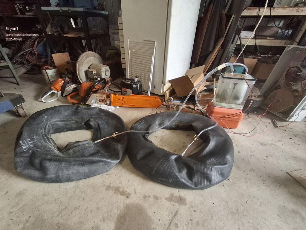

Well just came up to the shed and found the power supply was in OCP ( open circuit protection) and both of the tubes do have good signs of filling
Now what I expect is the amps slowly got to the max set point which was set at 8.3 amps so the OCD protection came in.
Now in that picture the tube on the left one can a distinct fold which now filled out and that one is the positive side ( Hydrogen ) and the other tube is is also filled out.
Just checked the battery voltage and I'd say it would of run for most of the night too and I'll run it all day today where I can keep an eye on it.
Cheers Bryan
Edited 2025-06-26 10:51 by Bryan1

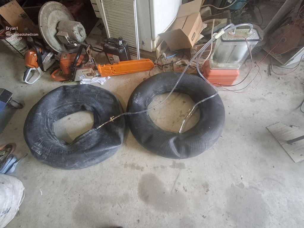

Well been running the unit all day and just noticed the current output had dropped to nothing
Man the unit was warm so left it for half an hour and topped up the water with nice cold water. Got back running on 10 volts with a 3.451 amp current draw.
Now silly me had my wires crossed and it's the negative rail that outputs hydrogen not the positive rail. Now as we are making 2 hydrogen atoms to one oxygen atom the way the tubes were filling gave me the tip so checked it on google.
Anyway below is the output so far
So as we can see the tube on the right is the hydrogen and it is not far away from being filled   I do have some E sized oxy/acetylene bottles to use as the storage and sorted the fridge pump for the hookup, also had a copper outlet for the acetylene bottle which will make for easy filling.
Cheers Bryan

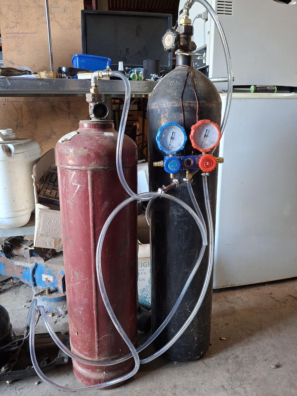

           Well decided to do the first decant just now and off the first batch got 20 PSI in the tank
Here is a pic of my decanting setup
First I pulled a vacuum on the tank using the fridge pump and used that cheapo gauge setup I got off ebay where found it only half finished. Anyway just using the ports I've found it's good for pulling vacuums and like today able to read the pressure attained.
I found the beauty of that clear plastic 8mm tube just a quick heat with a lighter then push it onto the 5/16" copper tube. Now I did find when I closed the valve on the tank the hose shot off as the fridge compressor was still going
Anyway I'm pretty happy it's only taken 2 days to do a cycle   also as the other tube is much larger I have left it and will decanter off the second run or sooner if needed.
Still a long way to go now it is looking good where for a few dollars one can make their own setup and best of all being off the grid the cost of power is zilch nada nothing
Regards Bryan
