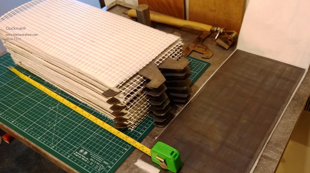

2 years later still slowly working on 60kg, 2v lead acid cells at about 450 to 550ah, using the PLANTE concept but a very modern design that is designed so anybody can make.
Plates design good and R&D finished.
Case design now completed and case components under stress and assembly testing.
Internal lead bus bars design concept good.
Will post stuff soon.

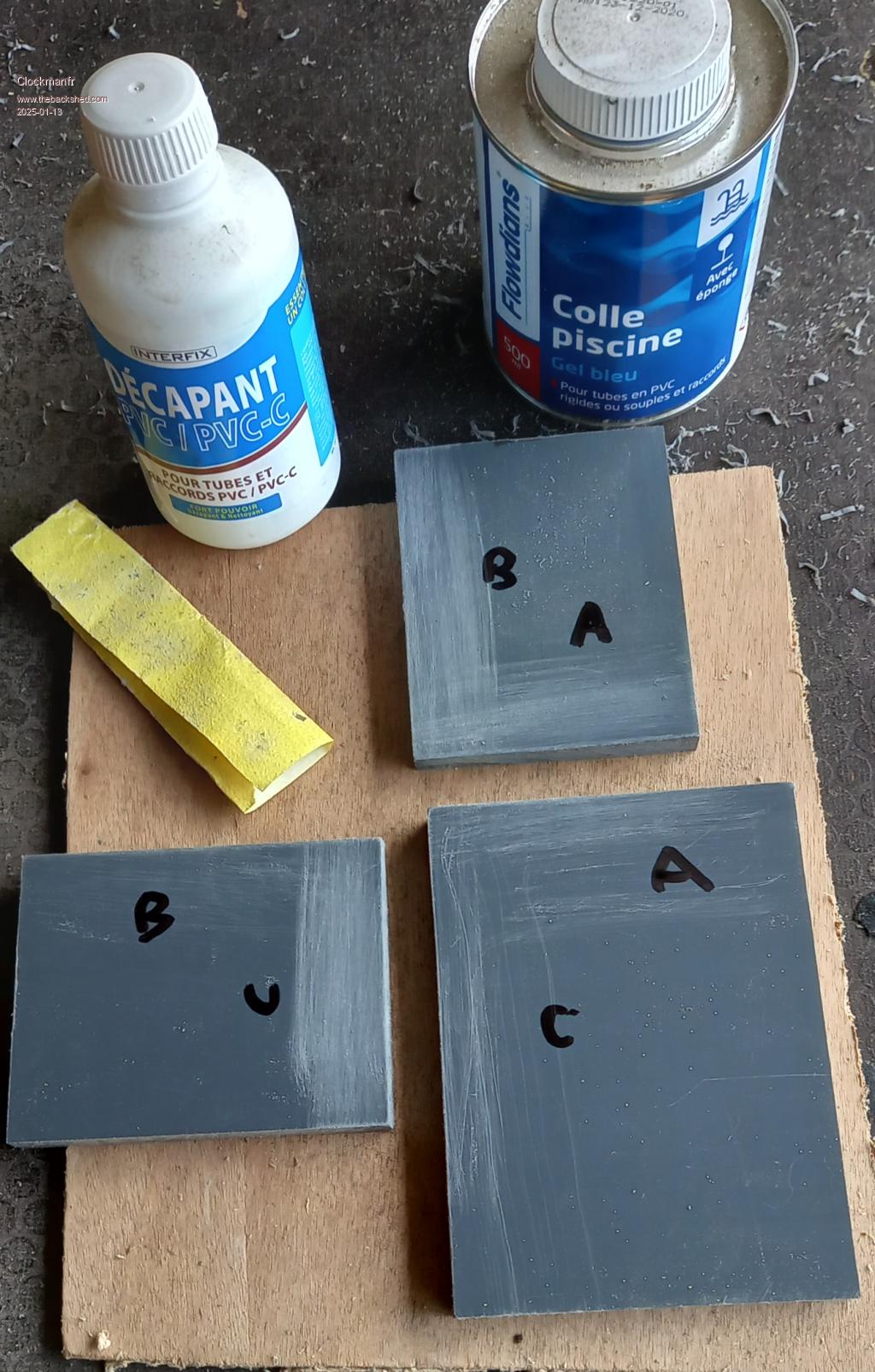

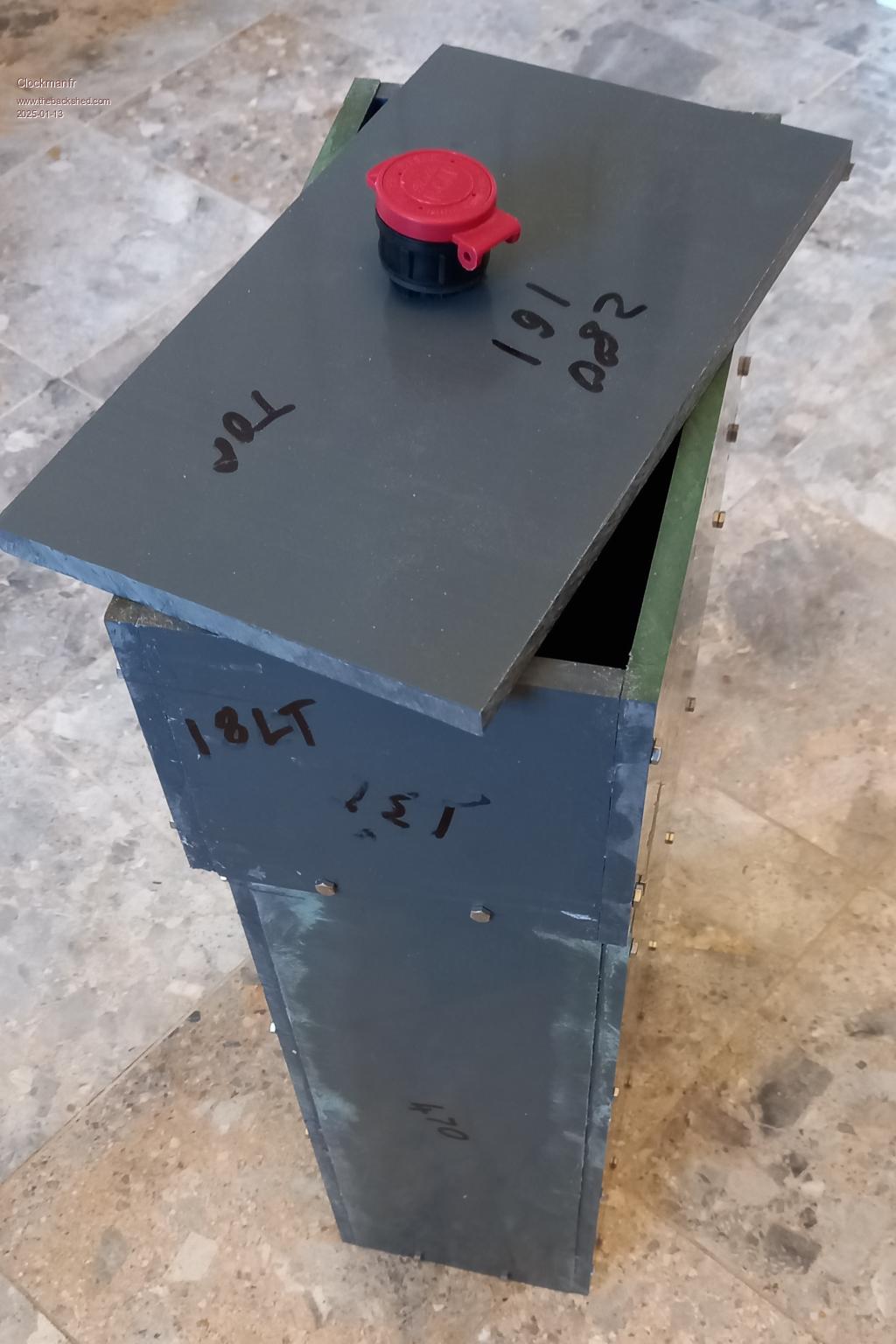

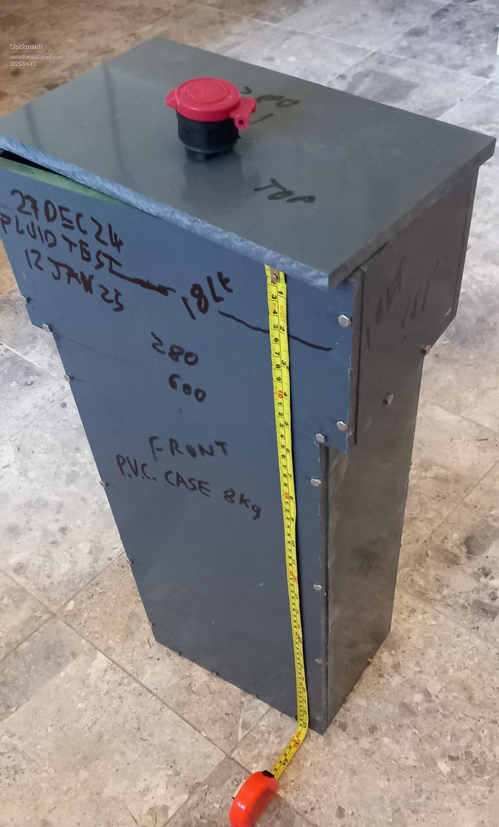

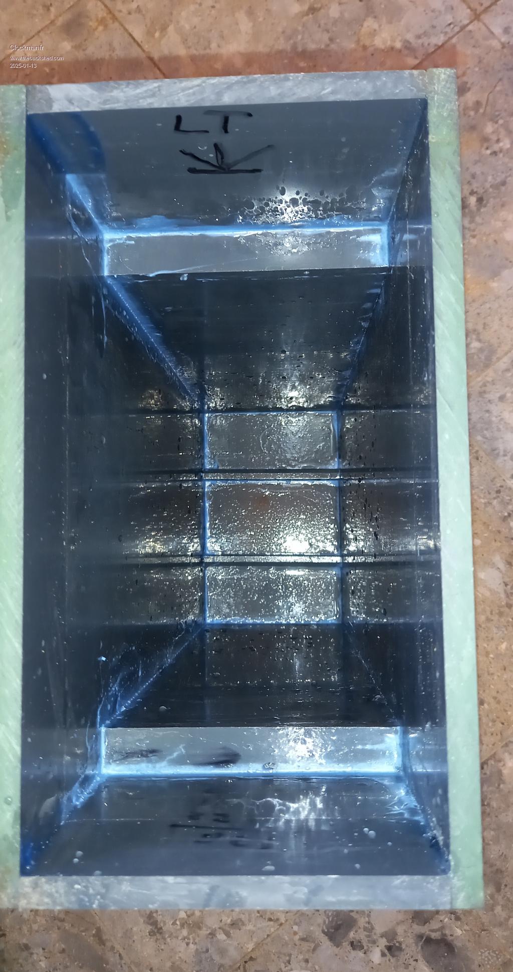

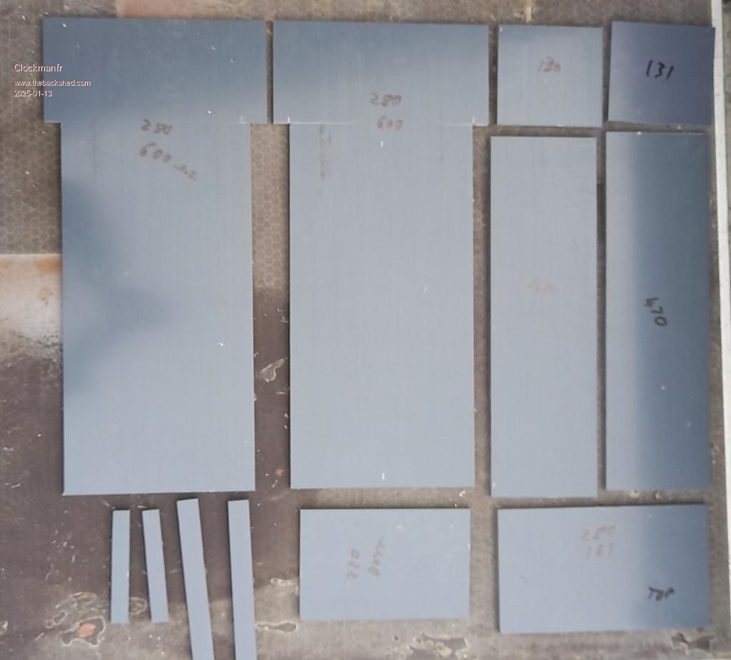

I started this project in late 2021, i have other projects so this has been delayed, but finally i am getting their, oh yea.
The Case of the NEW MODERN PLANTE lead acid battery.
Over Christmas the case has been undergoing fluid testing.  All good.
Remember folks, this is a project and concept that will be official published, tech drawings, designs and jigs design, and loads of colour photos, for anybody on this Planet  to make their own.
Designed and Now making the steel moulds so the internal plate joining lead bus bars can be easily constructed/cast.
