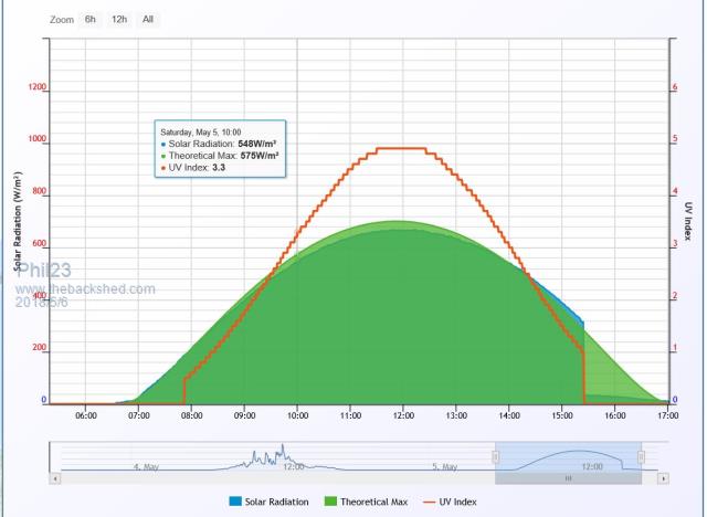

I'm assuming that's about right for this time of year considering my weather station gives the 10:00am theoretical Max as about 575W/m² for the day.

Output @ 10:00AM was 2000W or 65% of rated capacity.
The angle which the sun was striking them at that time was 2° off perpendicular in the vertical plane & 19° in the horizontal plane.
It was mentioned I should get more, but the facts above don't add up to that, particularly the irradiance reading.

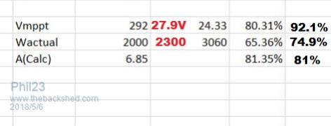

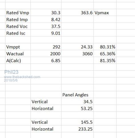

These are the actuals, so average panel voltage was 24.33V & current 6.85A.
I live in the real world, and don't expect the true test spec values, so presume all is Ok.

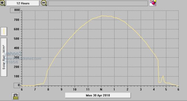

I am at 33 deg south and this is my solar insolence with a vertical sensor.
that tallies with your amps quite closely, looking at the graph in the data sheet I think you are probably 3.58 volt per panel down on your voltage theoretical max. Some of that might be mppt losses, the rest could be a combination of things.

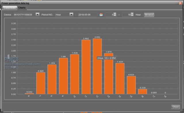

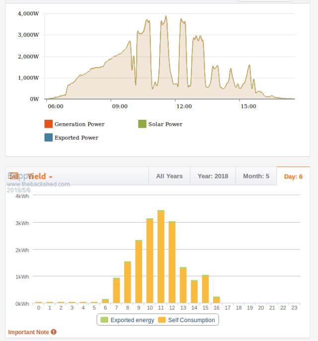

Thats the output here for today (SE Qld-scattered clouds) for 2x 3.2kw strings facing east/ west. It's noticeably down since xmas, where it was hitting the inverter peak around 9am, now its struggling to hit it at all although I am pleased its still hitting a kw at 7am. Solar HWS is also noticeably down, had to boost twice in the last fortnight, went for months without boosting at xmas

Posted: 08:50am 06 May 2018

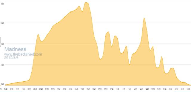

Here is mine with 2 X 3.5KW, these panels are laying flat, there is also shade until after 8AM.
There may have been a little throttling around midday with my GTI regulator.

this would be my guesstimate of what the maximum possible peak would be for this time of year.

Posted: 10:10pm 06 May 2018
Not getting anything quite as impressive as above; probably a lot to do with the fact that one string faces SW; the best option I have for it.
Don't go much on my monitoring software, very buggy & supposedly identical installs behave completely different in terms of the data layout they display.
An alternative would be nice.
Phil.

Posted: 10:32pm 06 May 2018
2.5KW from 3KW of PV is not bad.
