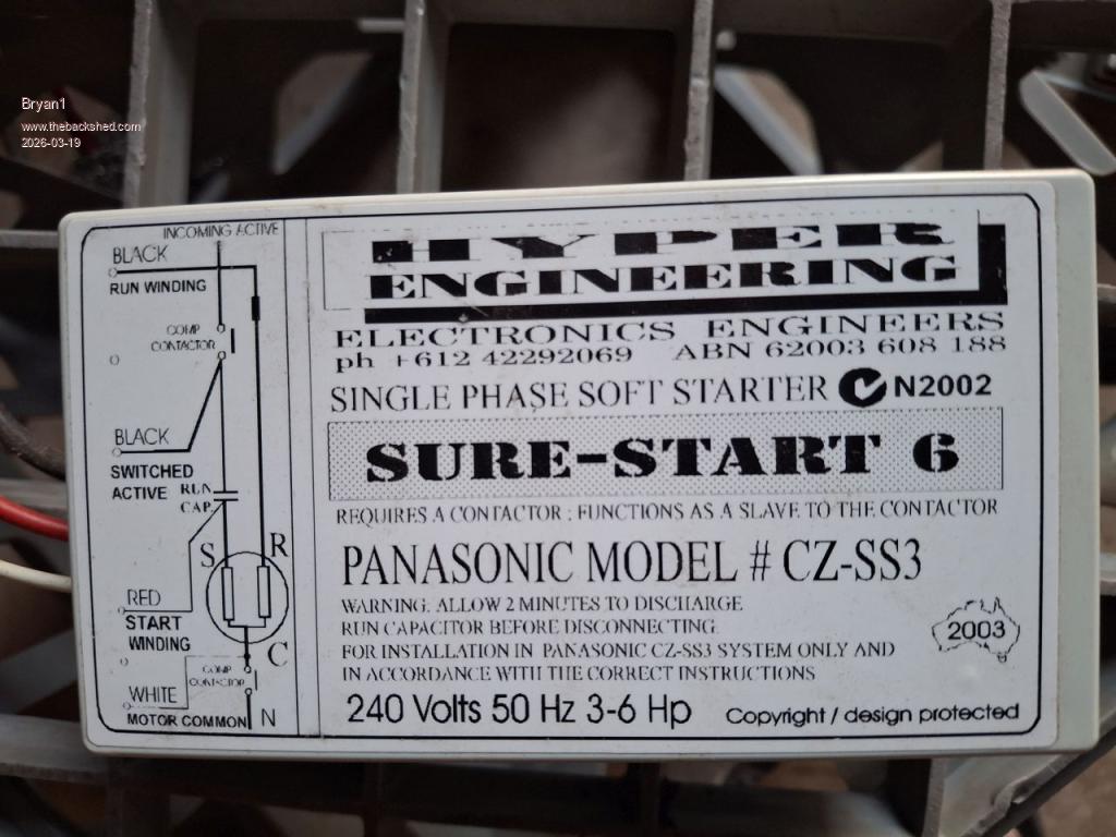

G'Day Pete I do have a couple of soft starters here and below is a picture of one
Regards Bryan

Bryan have you tried using one of those starters you have?
That looks like it is for an air conditioner.
I can't quite figure out what they are doing with that starter, but it looks like they are switching the start winding out of circuit after it starts.
Doesn't quite make sense to call the capacitor the run capacitor in that case.
Most motors with only one capacitor and no starting switch just leave the cap and start winding in circuit all the time.
